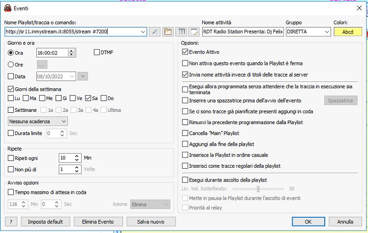

Good evening, to retransmit a program from another broadcaster, I connect via the special RadioBoss function, as shown in the image, the problem is that sometimes I had some holes that depended on the internet connection and the streaming disconnected, thus moving on to the next object of the playlist. Is there a way to keep the connection up in case of a few second gaps?

If you set a duration for the stream, it will reconnect in case of any failures. By default it will make two attempts and if those fail, it gives up and moves to the next item in the playlist.
You can adjust reconnection parameters in Settings, General, Advanced Configuration (button).

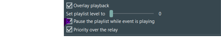

@djsoft Everything looks great now. One more thing. Is there any way to add relay to playlists? I mean a set for example jingle-relay 60min-jingle. All this is covered by events 3x per hour at set times. These event are Flash newses. These events are jingle-flash news-jingle playlists. In addition, I am interested in why, despite the fact that I have the settings as in the screenshot, the song under the overlay is still played?
This can be achieved by an overlay event with "Priority over the relay" option. Set this event to repeat every 60 minutes.
