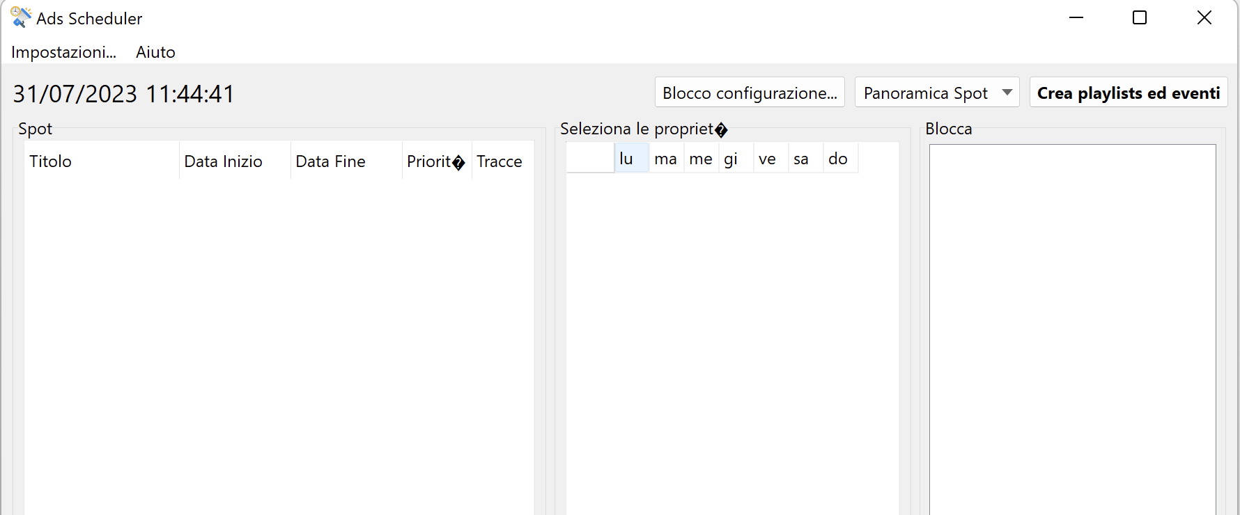

Thanks for the reply, I don't see anything here
Looks like you don't use Ads Scheduler, which means there's no way events in RadioBOSS could have doubled by themselves.
If I leave it like this, won't they conflict? It seems they are created every 36 hours. So far I've deleted them by hand, but they always recreate. Thank you.
You should check why the events are created. It shouldn't be happening, unless you configured it to do so. I suppose you should check all events you have to see if one of them, for instance, reloads event list (load command).

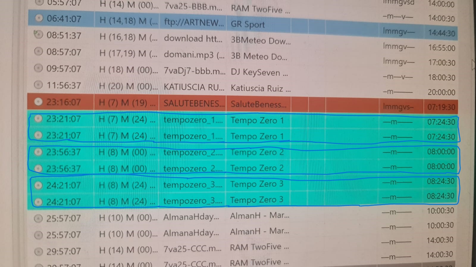

Hi, no one has the load command, attached an example, blue color, of how I see duplicate events. Thank you.
Hi, I see them identical. Thank you
Still, it's not possible for RadioBOSS to duplicate events - unless you instruct it to (there's "Duplicate" command in the menu, or when you import events). But it never happens by itself.
Tuttavia, non è possibile per RadioBOSS duplicare gli eventi, a meno che tu non gli dica di farlo (c'è il comando "Duplica" nel menu o quando importi gli eventi). Ma non succede mai da solo.
Hi, it seems to have fixed itself after multiple deletions... yes, I know the duplicate key but I don't think I've used it, much less for all the events. The mystery remains of how he did it, maybe I have a magic wand. Thanks again and good evening.

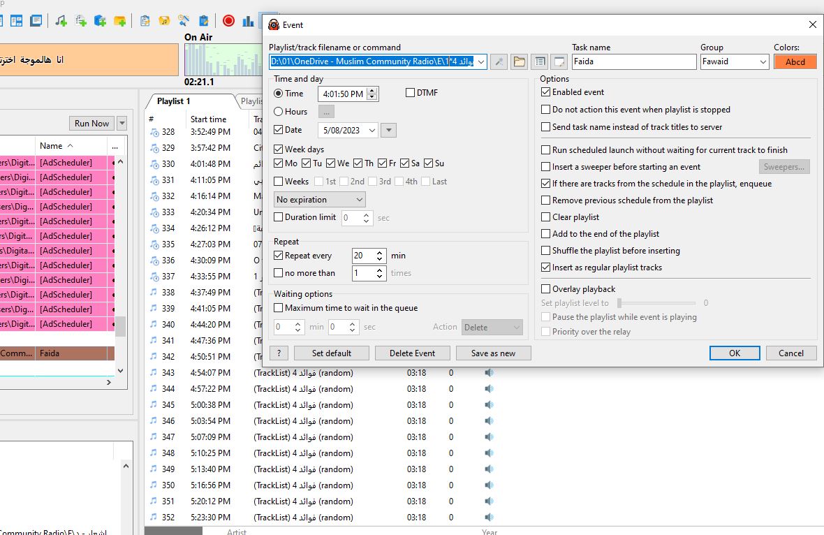

Hi, I am having a problem with a scheduled event if you can help please.
I tried many ways before I seek help :giggle:
I made an event to play a random track from a track list every 20 minutes, I chose to enqueue.
Everything was ok for a while then suddenly I found the tracks enqueuing at the end of the list.
I tried deleting the event and doing it again but it didn't solve the problem. Also I did reset RB to default and doing the event again but no good.
May be there is a simple thing that missed. Please see photo attached. Thanks
Your event is configured to be queued after other scheduled tracks (the ones marked with a small clock icon in the playlist) and this is what seems to be happening.
I Just noticed this small clock for the first time :giggle:
My question now is why do I have this small clock next to all the tracks in the playlist (around 340 tracks). It is an auto generated playlist every 24 hours.
Do I have to choose always the option (Insert as regular playlist tracks) to get rid of this small clock. As I remember it was ok before without choosing this option, it was enqueuing my other event after the playing track.
Thank you
All events, except for ones with "Insert as regular playlist tracks" will be marked as scheduled events (with the clock icon). Queuing always worked like this, since the very first release 20 years ago :)
