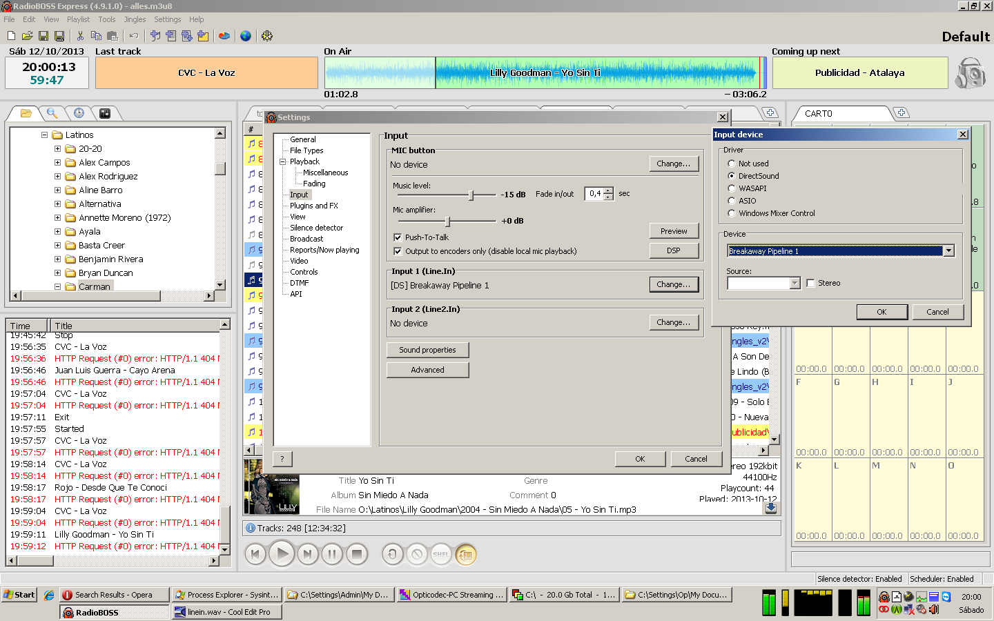

I have recently problems with the Line.in which come from winamp?s output. through breakway?s pipelines.

and a screenshot.  Oh, I have forgotten to say that the problem is often starting after a while, like half an hour or something. Sometimes it's hardly notable sometimes really bad. After restarting RadioBoss the sound is clear again

If you're using Windows Vista or newer operating system, try switching to WASAPI. Also make sure you're using the latest Breakaway version.
I am using XP SP3, also I have tried using Virtual Audio Cable, but the problem is the same. It seems like trouble refilling an audio buffer.
It looks like something is wrong with your PC. RadioBOSS was tested with VAC and it works flawlessly. Make sure you're using the latest VAC version (http://software.muzychenko.net/eng/vac.htm). If possible, try it on another PC. If you're using antivirus software, try temporarily disabling it - sometimes antiviruses cause incorrect virtual sound card operation.
