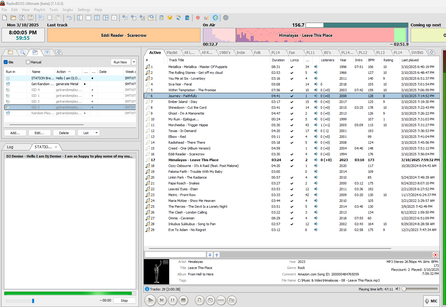

when using the function (see picture) in the playlist, the crossfade is not overwritten as it was set in the settings for commands
Locked up playing Playlist Overlay
And again, i had to disable all other tasks to stop it crashing in shedular latest version
Yes its more stable with only one running I asked it to play the others overlay and it killed RB would not unfreeze.
On the screenshot, the "pause #10" item is not marked with the file type's color. Also, timed pause is not a command so it will not be treater as a "command" file type (if this is the default file type and is not modified).
This seems to be version 7.1.0.3, please try 7.1.0.5, it actually has freeze bug fixed, and it should also cover your case.
