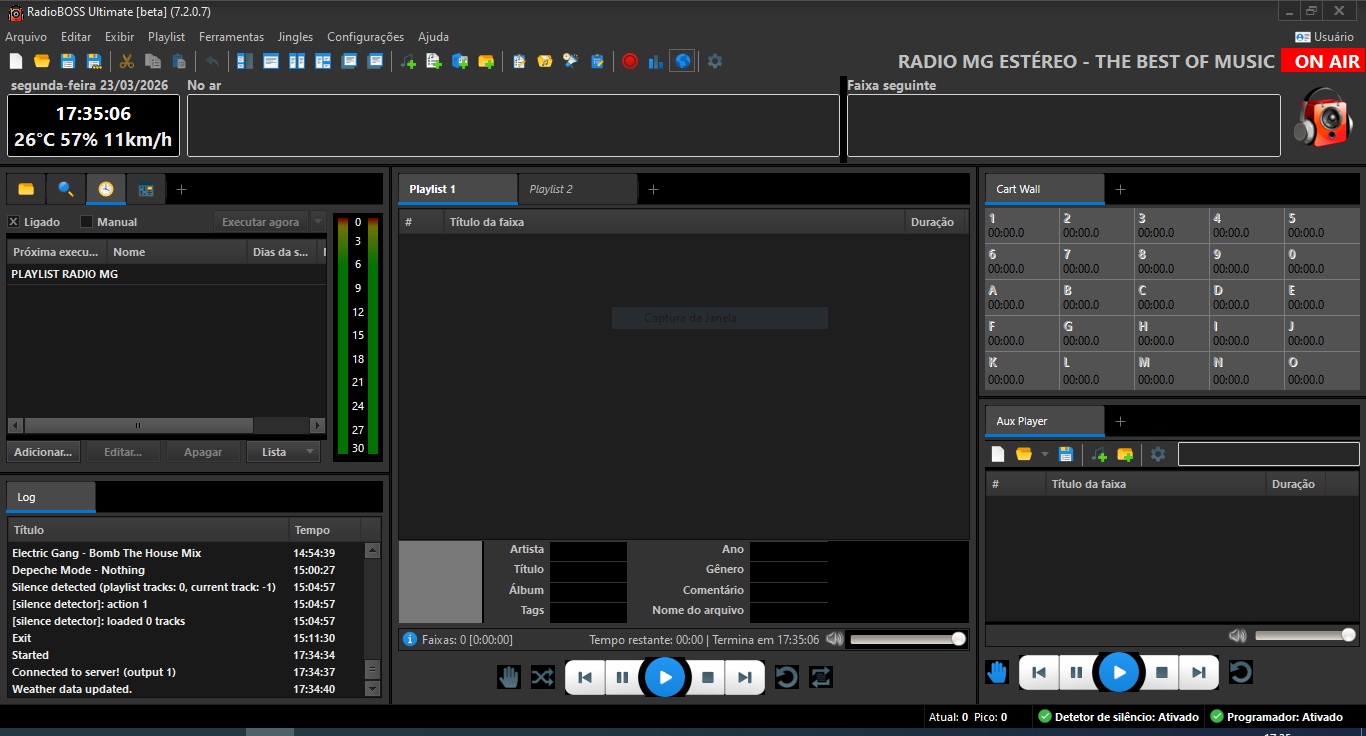

Yes, you can set the filters from the right-click menu. One of the ways to use them is to add a separate Logs tab in one of the work zones and set it to display errors only, this way you won't have to constantly enable/disable filters in the main Logs tab.
Beautiful RadioBoss
