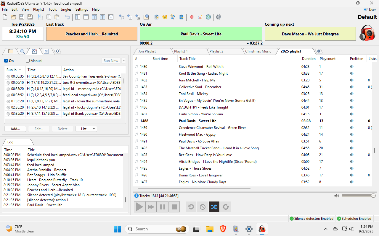

Here is an example of what we see when connected after an "outage"

It did detect the silence, and switched tracks. But the new track it selects doesn't play. When we connect to check the track, it can't be manually started either.

and this new situation is easier to handle actually. RadioBOSS detects silence but no music can be played either manually, or when silence detector starts the music, so it means that the sound device had stopped.
You can try the following: open Settings, Playback, for the main device, select No Sound device. And same for Monitor device (if some real/virtual device was selected there).
Didn't mean to add any confusion. The image was created after I initially posted and the Silence detector did fire, and switch track, but still no audio output.
The current sound device is (WASAPI) Default, and Monitor was already set to none. That said, we are passing a physical sound device (Through USB) to the virtual station. The device still plays audio even when RadioBoss doesn't. That is our confusion on why it hangs until closed and re-opened.
