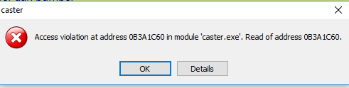

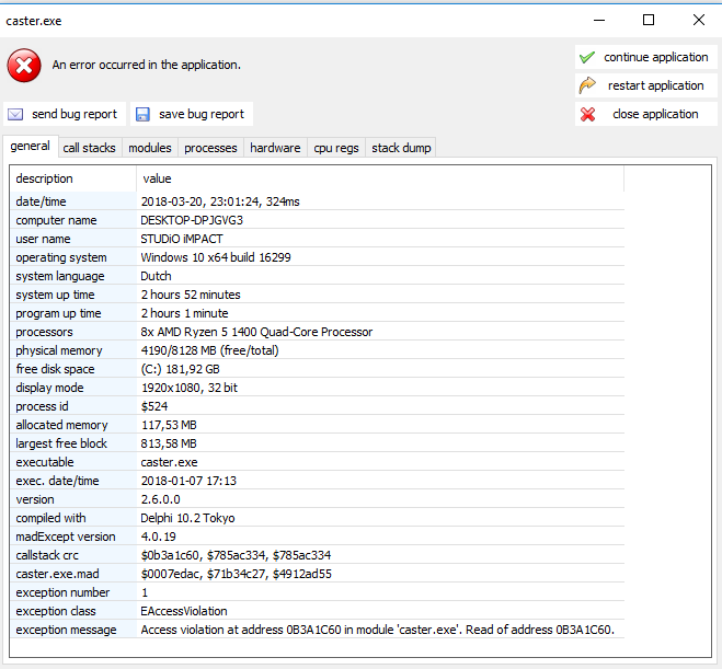

I have a issue with radiocaster that didn't bothered me before. Everytime i vlose it it gives me a error. What i discovered yesterday is that it also resets my vst plugins to their standard settings instead of the ones i've created.
I've insterted screenshots of that error because i'm having a hard time submitting a ticket for this (it closes rather fast before i can finish to send the error to djsoft). Anybody else noticed this problem?
This also happens on another pc and a laptop with just the demo version installed with a clean install with starting and closing it.
I suppose that be because of failing VST plugin. Can you please try disabling all the plugins, also turn off VST support in RadioCaster to see if it fixes the problem?

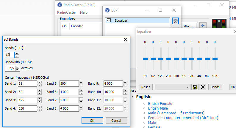

Just one thing remaining: The equalizer has the issue to stay stuck at 10 sliders. It's not possible to have more or less.
Yes, it appears to be a bug, thank you!
