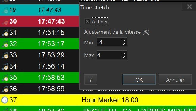

Dear Dmitry,
I'm currently trying to set up the Time Stretch system. I’ve activated the option, but I don’t see any titles adjusting their speed—either accelerating or slowing down—to finish on time.
Could you please explain how this feature is supposed to work and what steps I might be missing to get it functioning correctly?
Thank you in advance for your help.

I've tried entering several different values, but nothing seems to change — I don't see any segments speeding up or slowing down. The documentation doesn't help me understand what's going on either.
Maybe I'm misunderstanding how the system works? Is it supposed to be the last track in the playlist that gets accelerated to match the end time? If so, no matter what values I use, it never aligns properly with the final timestamp.

It will show in the first column what tracks were sped up/slowed down, it will change the speed for all tracks up to hour end. Hour markers are placed automatically only, and time stretch only works for hour end (that is, target is always :00 minute of the hour).
For testing, you can try setting some extreme values like +-25%. Also check what exclusions are made. Time stretch is not applied for file types (unless the file type has "Treat as a music track" option).
