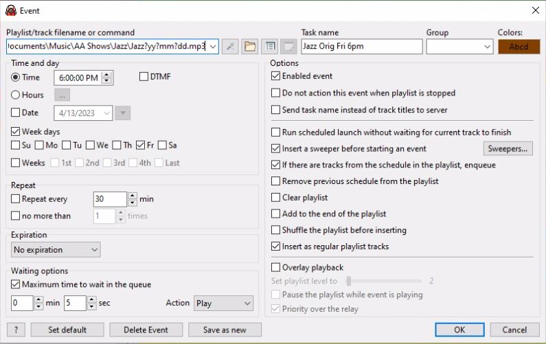

Seems the author of this thread has the same issue as me. I attached a screenshot of the way I schedule events. And my issue was that my events go straight to the bottom. From what I read above, it appears I should uncheck the box which says "if there are tracks in the scheduled playlist, enqueue". So, if I uncheck this, will it solve me issue?
