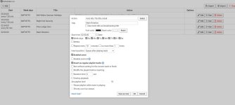

Ok another late night I decided to try a simple test and report back my findings which didn't surprise me as this has been my problem but I have no idea how to address it. I have read the documentation on the scheduler many many times but I assume I must be missing something. Please help.
So the test was to create a 30 min show of 60s music.
As you suggested I created a playlist which consisted of 18 tracklists each a random selection of a track from my 60s media folder, plus 6 jingle tracklists from my Jingles folder. This would play for about 48 mins so a lot longer than the required 30 min show.
The scheduled event started at 2:16 as it had to wait for the track "perfect" to finish from the main rotation. It showed it had activated at 2:15 which is correct but waited for the song playing to finish.
The log shows it loaded 24 tracks 18 plus 6 jingles great so far. It then played exactly how I wanted it to BUT after 1800 seconds it saw the duration limit and recorded it in the log but then proceeded to carry on playing that track and many more until it had played out the remaining "extra " tracks. I was wanting it to stop at the end of 1800 seconds and change over to the main rotation it didnt!
I also had that strange situation where the remaining tracks were playing out on air together with the auto dj so audio from both auto dj and the scheduled over run tracks playing out.
Summing up why does the duration limit not do what it says and tracks keep loading and are played.
why when its in this situation does the main rotation play at the same time as the over running scheduled track.
Please study the log Screen shots . I really hope you can help me with this it has now become a nightmare I am currently thinking of a new automation program if this cant be fixed which would be a pity. I have been a loyal customer to Radioboss for many years but this is now driving me mad.
P.S> before setting this scheduled event I sent the main rotation to the player so we had a clean start.
Thanks for your help.

Please see below for the latest situation
I also had that strange situation where the remaining tracks were playing out on air together with the main rotation! so audio from both main rotation and the scheduled over run tracks were playing out.

My main problem now
"So basically if it has lets say 4 more possible tracks to play that would take it past the duration limit these would all be skipped which is fine but it has to be told where to play the next track from. In my case I want it to go back to the main rotation and loop in there like normal but what actually happens is it plays the next track from the remainder tracks which by now should have been deleted."

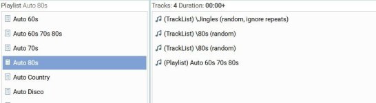

Update I just tried a short test this wa to play two tracks from the auto80s tracklist. The plan was it should start immediately and play most of the first song it played it all then detected it had gone past the 120 second duration limit. it shows that in the log says next track and proceeds to play what would have been the next track in the auto 80s tracklist which due to it reaching the duration limit should have been deleted. At the same time as it logged reaching the duration limit the main rotation started up! and played at the same time as the track it decided to play even thought it and any others should have been deleted.
This is the current situation
When the duration limit is reached, it will skip all tracks from the event, and play whatever's next in the playlist. It can be another event, or track in the playlist - depends on what's in the playlist.
To make things simpler: do not use Duration Limit at all. Schedule events to start when needed, in the majority of cases, that's enough.

It can be created manually, add as many tracks as needed, or rotation-style and start it with "Replace playlist" option (playlist is on repeat so it will play until something else is started). Duration limit is not needed for this.
Advantage of starting everything with the events is that you know what starts when. If you use the Duration Limit, you don't really know what will play after the event is skipped, as it depends on what will be in the playlist at that time. Duration Limit has certain (limited) uses, but in general, you should build your programming with events and set start time for them. It will be much easier to manage and understand.
So basically, you can simply swap rotations using the "Replace playlist" option to start a new rotation.
