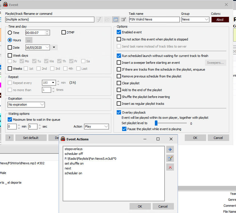

This what I try to do :
Before the podcast or news start :
Stop any other schedule task that overlay (I have some than run every 4 minutes and will talk above the playing track)
stop the scheduler
play the track for news or podcast
restart the scheduler
shuffle on
move to a tab
I have tried the multi event feature and it did not work. Commands are not executed. So I thought a playlist could do the job
I created the the playlist using the Playlist feature and adding the commands and track using the menu. It worked so then I saved to load this as a playlist and it does what it suppose to do. But if I schedule a task to play the playlist it does not execute the commands. Only the track is played
Do I do something wrong ? or is it a special grammar I miss ?
