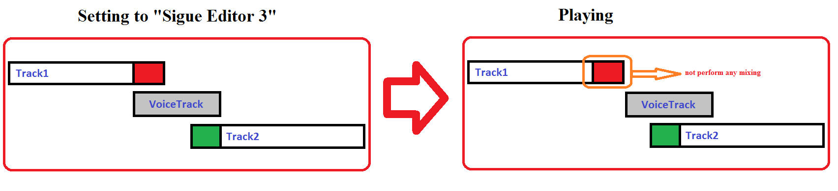

has introduced a new error:
when using crossfader editor 3 in a voice not keep track exit points of the first track, so the voice track is played back without background music

When voice track (a track marked in italics in the playlist) is played, some of the mixing parameters are ignored, instead, Outro and Intro information is used.
hello, well in this respect, it is an error, please look at the picture.
Well, probably... It's a question of priorities: Intro/Outro or what is set via Segue Editor. Maybe you're right and Segue Editor, if was used, should take precedence... I'm not sure yet.
