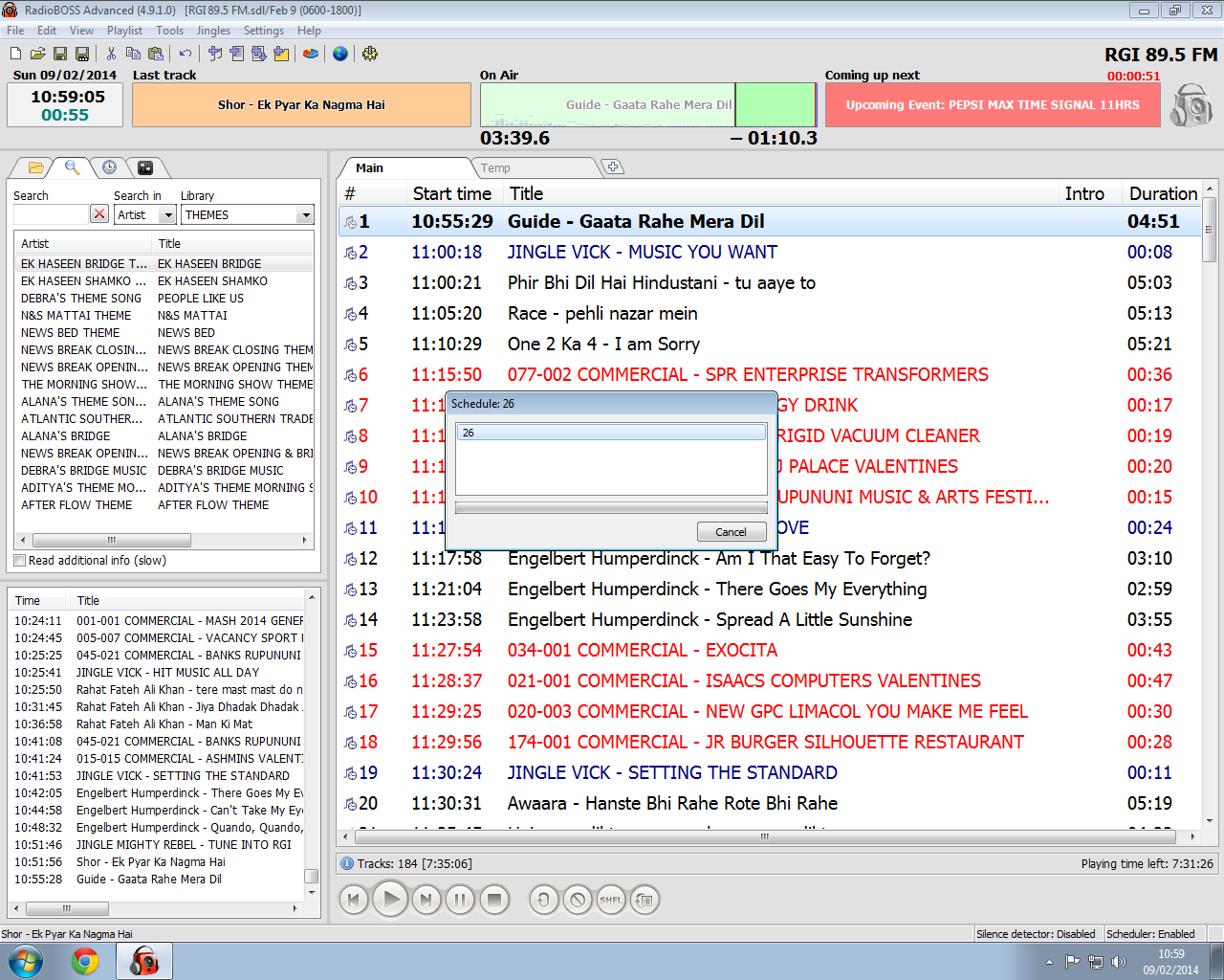

over the past two weeks i got a popup on my playout computer from RB saying "Scheduler 26"
it does not say error but what it does is limit the playback volume significantly,this popup occurred twice  when the studio was unmanned, can you say what is causing this and how it can be rectified.

Hello Dimitri here is a print screen of the scenario i am speaking about

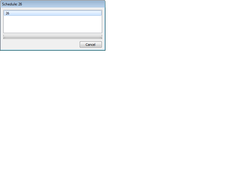

It looks like you have scheduled event with filename "26" - please check your events list.
i can assure you  there is nothing with that name scheduled our events are thoroughly scrutinized before being imported into the on air studio.
It can't popup windows by itself without any reason... From the screenshot it's clear that there's an event with "Overlay Playback" option and filename "26" (or there's a Track List with playlist source and playlist has this "26" file). You can save the scheduled events list and send this .sdl file to support@djsoft.net probably we'll find the cause.
