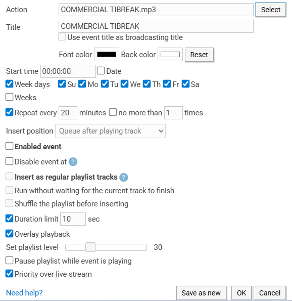

This is done, but metadata is not sent when an event with the track is initiated (even if priority over the relay) is set. I do not need to send the metadata when the relay is playing, but I need to send metadata when any event is started, because metadata it's to ad triggers.
Am I doing anything wrong? Thanks!
Yes, this is by design. Overlay events never send track title updates.
We'll add a command to allow updating title with custom text.

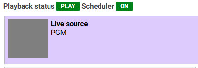

Got it, thanks. Also, I've created a playlist using line input and this will avoid buffering, once the live audio is not coming from a internet relay, but over the line in from a mixer. Thanks!
