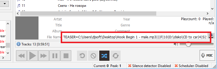

To add teaser at the beginning of the generated playlist:
1. Create teaser in RadioBOSS with the parameters you need. Select it, and copy the teaser command from the Filename field in the Track Information window (please see the screenshot).
You should get something like
Code:
TEASER=C:\teaser\Hook Begin 1 - male.mp3|||F|10|D:\Music|4|S|5000
2. Open Playlist Generator Pro.
3. Add a category. Check the "Use this category only once" option. In the Tracks tab, add the copied teaser string to the Tracks source list. Click OK.
4. Add the newly created category to the beginning of the playlist.
Now, when the playlist is generated, it will have a teaser at its beginning.

Wow, seriously that easy, I was thinking way too difficult apparently. Quick test showed it played like a charm - now up to some more simple configuration 8) Thanks!
