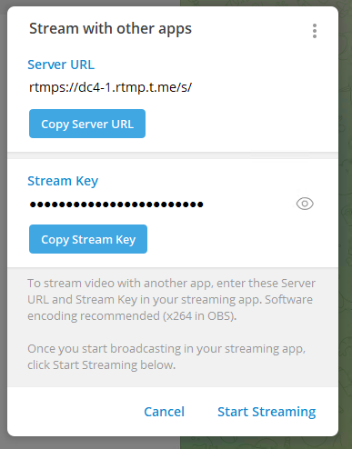

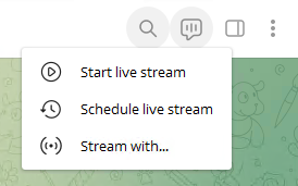

Open your channel or group in Telegram App, then press the Live Stream button and select Stream with...
Leave the window open, the Server URL and Stream Key will be needed for the next step.

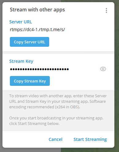

Hello, I try with the given configuration and the codes of my test group on telegram, but telgram tells me that it cannot find the flow even though the server address and the key are correct
What am I doing wrong?
I think you should re-check all the settings, also see in the log if there are any error messages.
