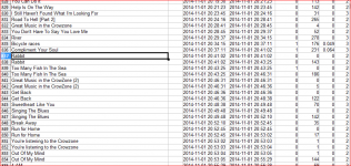

I looked in the zip report file from Centova, and it seems that most (but not all) tracks are being reported twice. Firstly with no duration (or maybe 1 second) and then with a normal duration. Of course this will count as two plays and so is messing up my tracks per hour.

I have tracked down when it seems to start - 1st Nov 2014 at 20:41
I will look to see if I can find anything significant about that time, but it does not coincide with having two mounts (as that was in October)
I've contacted Centova support regarding this, and they told that Icecast reports tracks each time for each mount. E.g. if you have 2 mount points, you'll have 2 entries for each track...
I would understand that, but I only have one mount (I deleted the second one in Nov/December I think)...there's certainly only one mount defined now and it's still reporting high numbers of tracks per hour (40+ would suggest an average track of just over a minute!).
