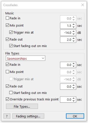

Hi,
I checked and no Mix Point was set.
I have now enabled Fade In and Fade Out with both set to zero. Let's see what happens.
The problem only occured randomly. Playing the two ads again straight after would not trigger the problem.
Lets see what happens now.
Chris M
You can also set the Mix to zero, and check if any other file types have the "Override previous track mix point" set - maybe they cause this mixing.

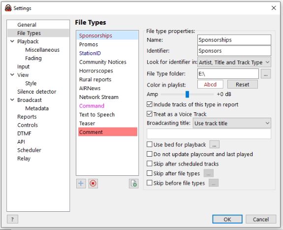

Hi djsoft,
I set the fade In at 0, Fade Out at 0, enabled "Override previous track mix point", and there are other file types with that set such as News, promos, stings, etc which are set identically so that there is no Fade In or Out.
Mix is at 0 for all file types in the list.
