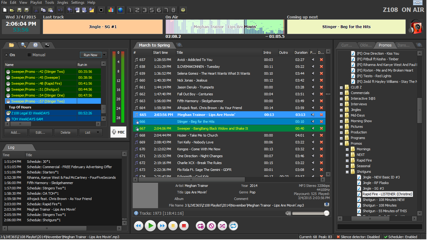

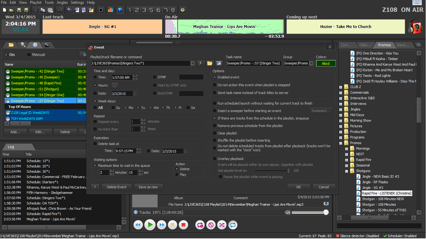

Here is an attachment of the schedule and how it's not removed from the playlist after the designated time and still plays.
Thank you. It looks like it doesn't work correctly when Track List ("Select one track from playlist/folder") feature is used.

The original issue was that tracks were not deleted when using the "Wait..." option. We can't reproduce it here, as scheduled tracks are always deleted when they are expired. Are there any other scheduled events which are executed at the same time?
No other tracks are executed to go off at the same time. We are using the "Play one track from playlist or folder" option, selecting the folder in which the event should pull and choosing the selected times in which the scheduler should queue them in the playlist - using the enqueue after track box and a 3 minute wait time in the scheduler before deleting. Everything works as it should, however the track is remaining in the playlist after the desired 3 minute wait time. Going forward, can you offer an 'expiring track' option where a deleted schedule track will indicate itself by blinking within the playlist, or turn a shade of red 10 seconds before removing itself from the playlist?
It still does not reproduce here. One potential cause for this behavior was located, though. The next version will have it fixed.
