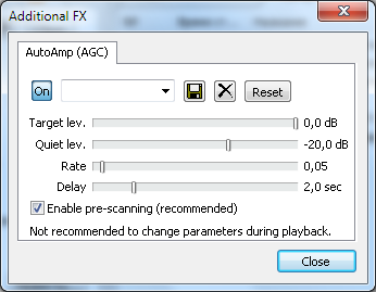

I checked the files and they play fine here...
The first song starts @ x0.94 amp rate and keeps around this till the end. The second song started at x1.83 and the peak amp level I see was x2.5.
Please see the attached picture, there are the settings I used.
Dmitry,
Thanks for trying these out! I did a bit of tweaking, and the songs still clipped to the extreme. After a bit of investigation, I found the problem: somehow, these two songs didn't get encoded to mono to play over the mono PA system. When the PA saw this, it tried to overcompensate to handle the stereo signal and brought the music up to extreme volume levels instead of kicking on the clip preventer. It turns out that the problem wasn't with RadioBoss at all! I'll try to troubleshoot better next time. Totally my fault.
