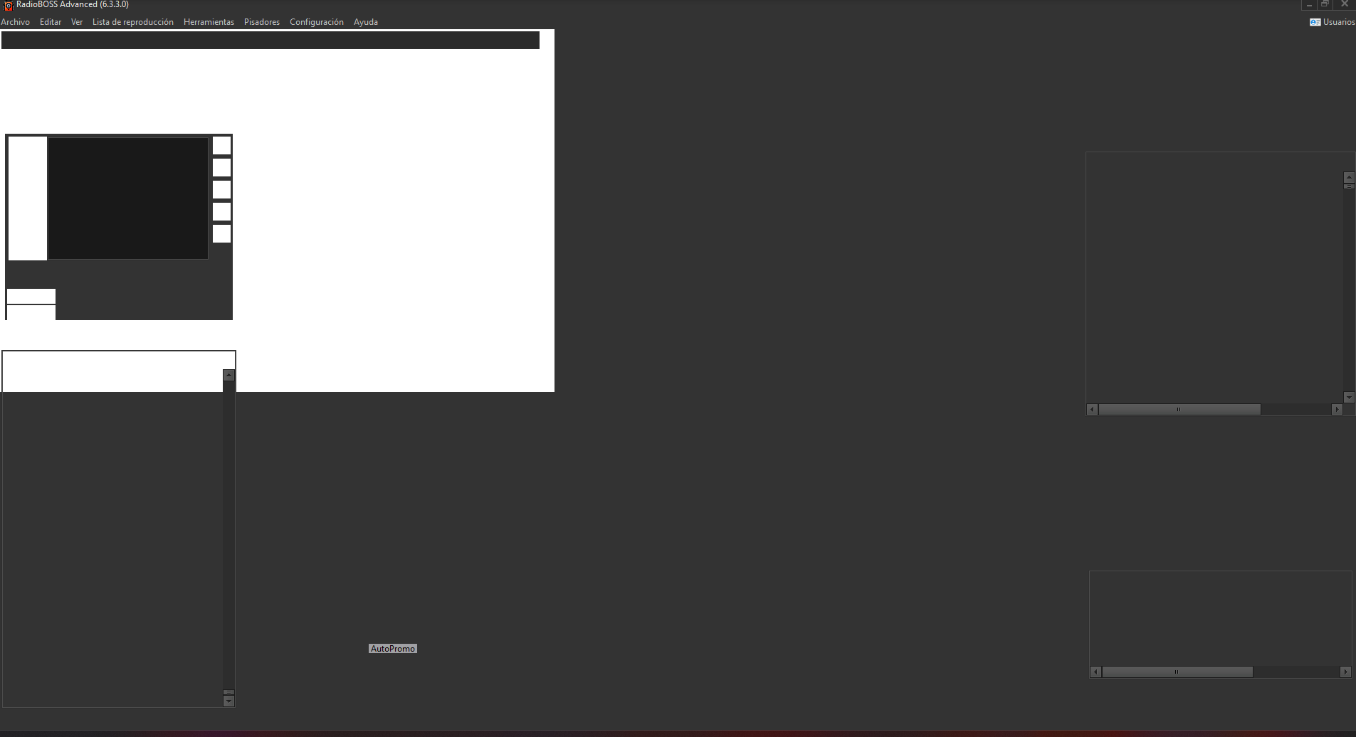

My boss radio keeps blocking when I broadcast programs.
Hello, I have investigated more and something happens when the advertising break is inserted, (well more like when the turn comes to be played) that it blocks, no matter what files it contains it blocks, it is even more so if once inserted (automatically or run now) an advertising pause, the files are manually deleted, when the time comes when said files were there, they are blocked. If I remove all the ad break schedules then it works fine. If I run it again so that they are generated, then when it's time the problems return.
