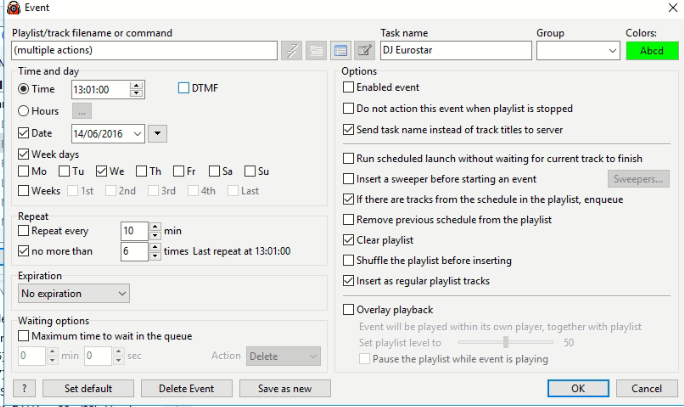

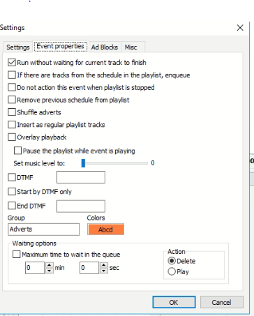

So, I have set the advert scheduler by removing the "Insert as regular track" as recommended and also set the DJ event to 'insert as regular track" (as a number of live stream segments) The advert was updated (set to update every hour), however when the DJ event is triggered (manually or by timer) it still cuts into the ad breaks.
The DJ track must have the "If there are tracks from the schedule in the playlist, enqueue" option enabled to make it insert after the ads event.
I suggest you to read options description for better understanding: https://manual.djsoft.net/radioboss/en/eventoptions2.htm

Just to recap, Scheduled events are set to:
- If there are tracks from the schedule in the playlist, enqueue,
- Insert as regular playlist
Adverts Event properties are set to
- Run without waiting for current track to finish
- Insert as regular playlist is NOT enabled
