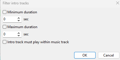

Hey Dmitriy,
There is no explanation of this functionnality into the Radioboss Documentation :
Can you detail how this thing's working actually ?
Best
Altec
Hey Dmitriy,
Best
Altec
It basically selects files that meet the minimum and maximum duration values to overlay over the song's intro.
For example, you want the intro to be at least 5 seconds long, but no longer than 10 seconds.
Furthermore, if you check the box, it should only play over the music.
I have noticed that sometimes the autointro vocal track starts blank before the song when it is longer than the song's musical intro. So, do I just need to tick the box if I want to avoid this?
The duration filters are useful, for example, if the autointro lasts 5 seconds and you want to avoid it being played on songs with a 20-second intro. In this case, I can set a maximum intro of 6 seconds and a minimum intro of 5 seconds, for example, so that the track plays perfectly on a song with an intro lasting a maximum of 6 seconds.
First are the duration filters, to only use the Intro tracks that match those settings. "Intro track must play within a music track" - additional duration filter to ensure that the intro file will play within a music track (without this option, an intro might start earlier and play before a music track starts).
Yes.
