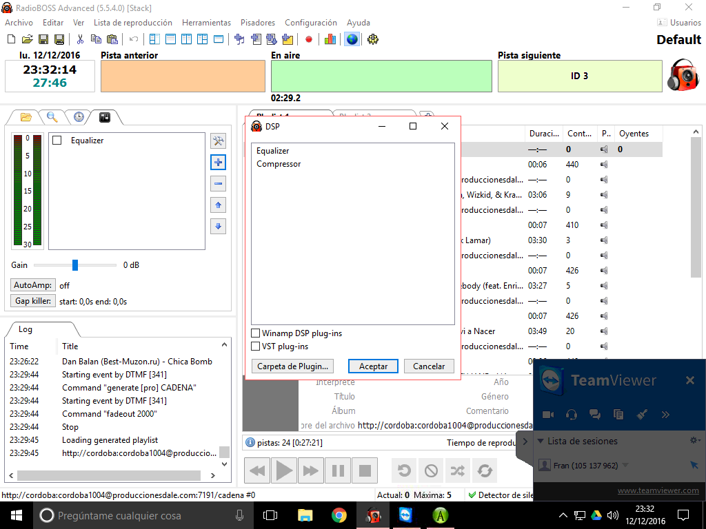

Without sound processing, RadioBOSS plays the track as it is. If you remove sound processing and the track still doesn't play right then I suppose the track is recorded this way. Another possibility is that you didn't disable sound processing completely (something still left enabled, e.g. Compressor) - please post a screenshot of your RadioBOSS window with DSP tab open.
RadioBoss connect to a streaming and it still doing the same, is very strange.
The DSPs are disabled, so I suppose the problem is either with files you play, or it's something to do with sound card (e.g.sound processing is enabled there).
