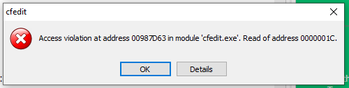

Hi there, I've just upgraded to v6.0.6.0 and I am receiving an error when trying to load the segue editor
Please click the Details button, then Seng Bug Report, we'll see what's wrong there.
Does it happen for all tracks or only for some?
A hotfix will be released shortly to resolve this. It only happens on some computers.

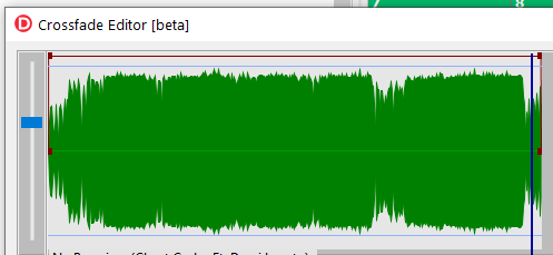

It would also be awesome if the edited size of the waveform when gain is added in the segue or track tool would appear in the on air bar at the top. Here are some images to explain what I mean:
I've added gain to this track (as you can see) but here is what it appears as when playing "On Air"
It's still the original size :)
This will be improved in the next minor update, it will take into account the Playback Level value when displaying the waveform.

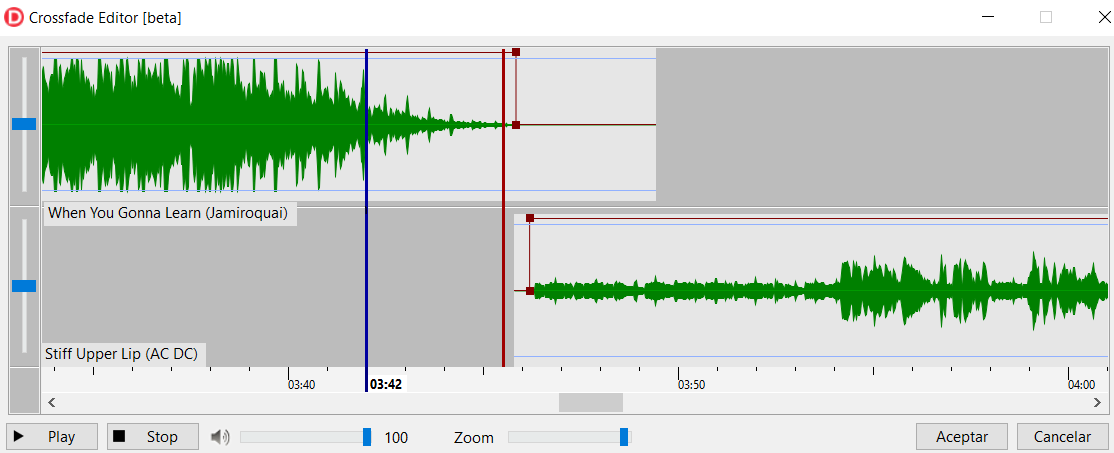

How much time before? Can you please send a screenshot of the Segue Editor window so we can try it here with the same settings?
Something like this. When the zoom is at its maximum the difference is clearer.
In this image, the sound of the next track in the preview begins to play

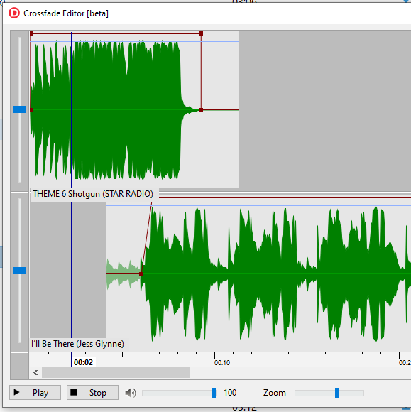

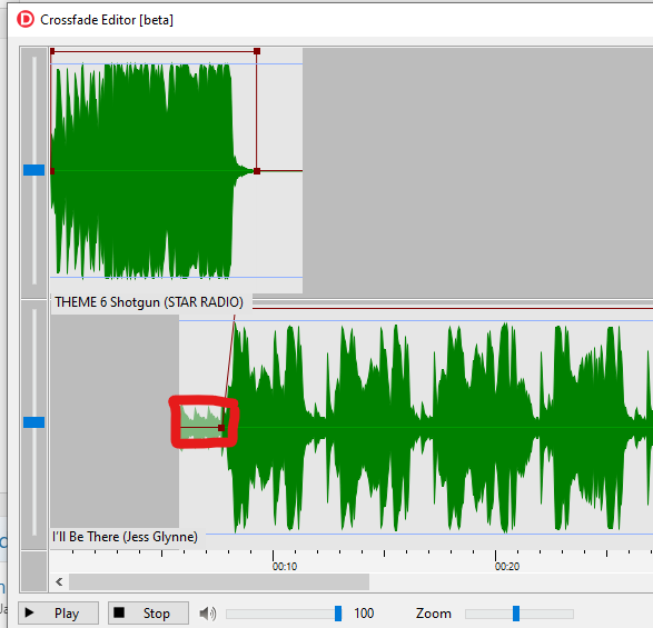

I have also noticed a bug which only happens when you use the first fade keyframe that choses when the track starts:
I'll set the track to start like that, but when I click OK, and open it again, then the bottom track shifts to the left:
If I correct it again and click OK then it seems to work but it doesn't work the first time round :)
