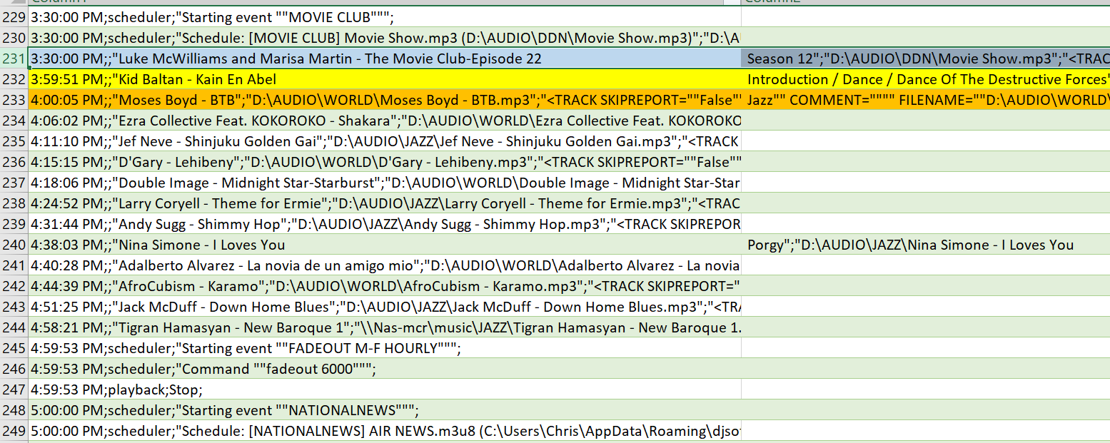

No I don't believe so. Did you not read my post above in detail? See extract from the log which shows no evidence of the scheduled program "Hit Parade of Yesterday" at 4.00PM. The preceding program is there (blue), followed by the sweeper (yellow) then a track (orange). There is no sign of our program. The 4PM program should override the sweeper.

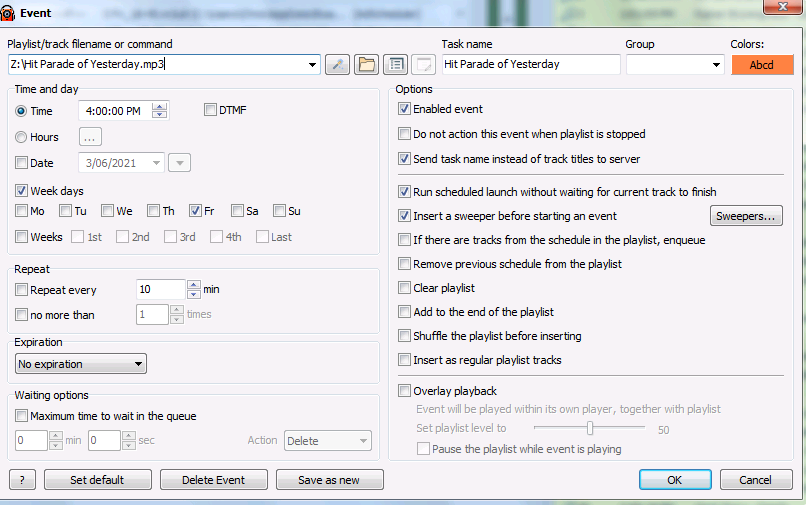

The event below played successfully, but only after I had completely deleted the event from the schedule and created a new event from scratch using identical settings. BUT, if I edit the event by updating the file with a different file to run at the same time, using the same settings, and save it - it doesn't want to play. I noticed the drive requires some defragging, so will try that to see if it makes any difference.

Do you edit the event using the event editor in RadioBOSS or you modify the .sdl event file using some other software?
After you edit the event, it enters "cooldown" state - that is it won't be started for a couple of seconds. If you edit the event e.g. 5 seconds before it's supposed to start, it may not start. You can see this "cooldown" in the events list - the "Next Run" and "Run In" columns become empty right after the event is edited, and after the cooldown passes, you will see the valued there.
