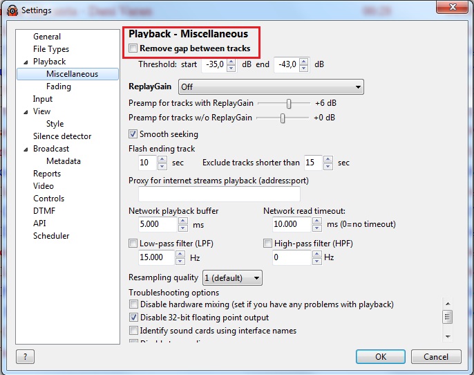

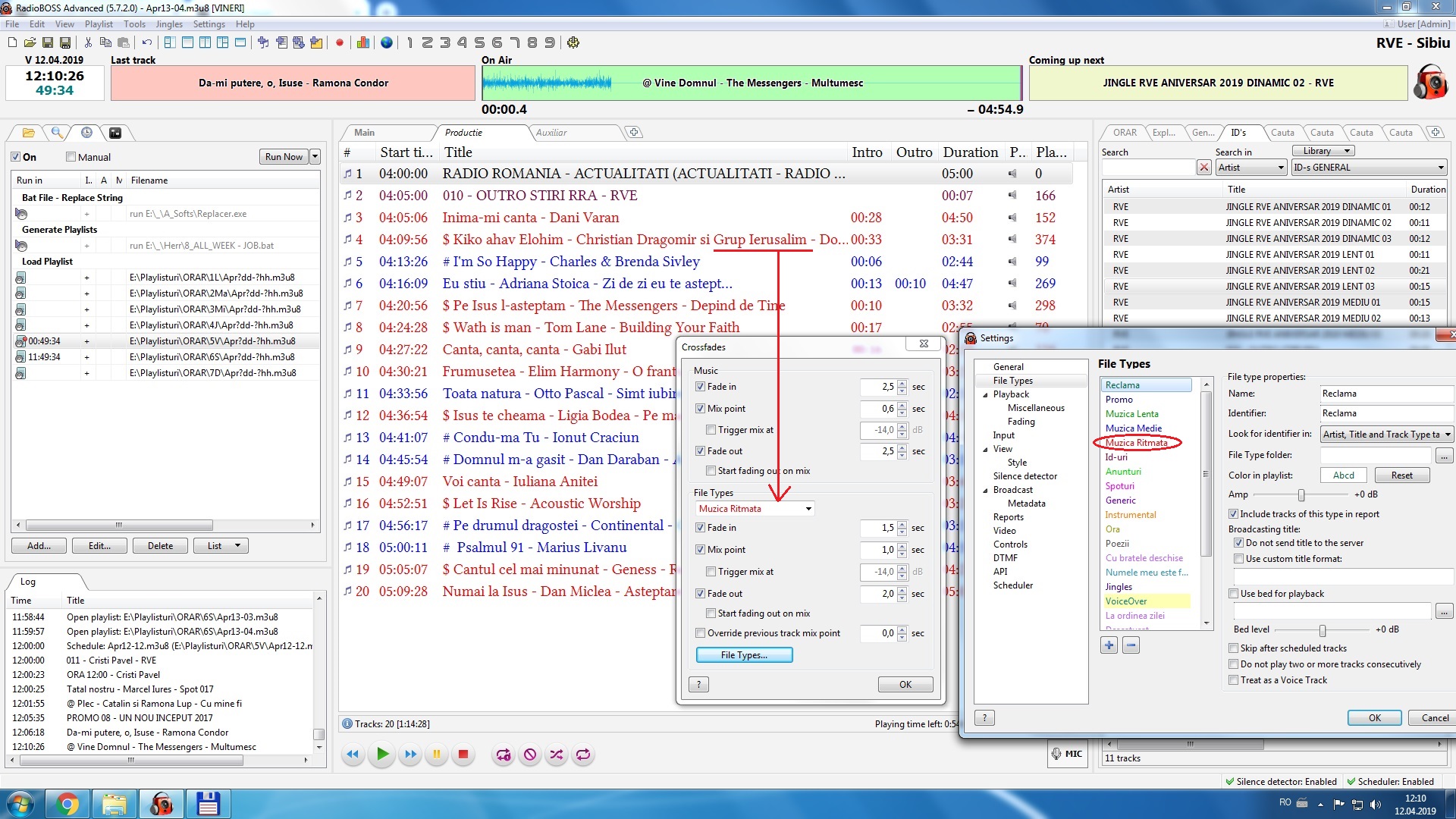

It is impossible without File Types in conjunction with Crossfades.
But you can try: Remove gaps between tracks.

I use playlists for every hour with
  • Crossfades
  • Start / End for every track
  • Without (uncheck) Remove gaps between tracks.
No runtime changes.
But I do  not use latest RB version which is buggy. I use 5.7.2
