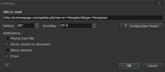

I have created a GET request that should call me a URL when connecting and disconnecting.
It works when connecting, but unfortunately it doesn't work when disconnecting.
Is there anything else I need to consider?

I installed the trial version of 6.0.4.0 and unfortunately it doesn't work there either.
When I connect, I get Connected to server! (output 1) (Profile: Default, instance: C:\\Program Files (x86)\\RadioBOSS6040\\radioboss.exe). When I disconnect (Broadcasting turned off in RadioBOSS), I do not get a GET request.
It only sends requests when it's disconnected due to connection failure or for some other reason. It does not send the notification when you disconnect it manually.
