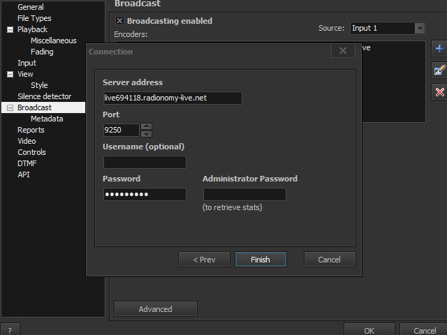

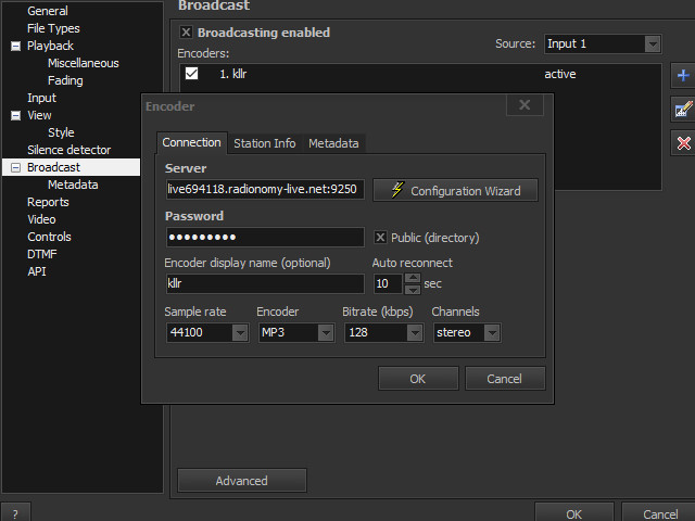

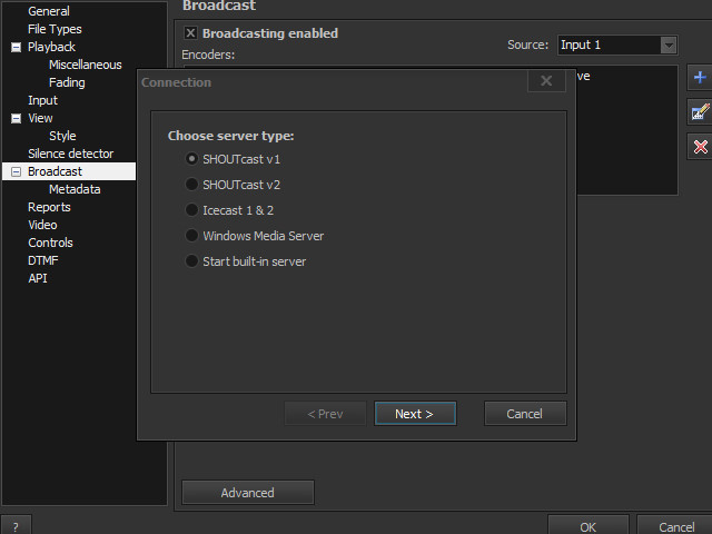

tried them all , deleted them all before opening the build in encoder of RB, still no connection eventhough I get NO ERROR....
If there's no error, then encoder is connected successfully and the problem is somewhere else.
From your screenshots I see that you use Source: Input 1 (in Settings, Broadcast section). Change it to Audio Mix.
