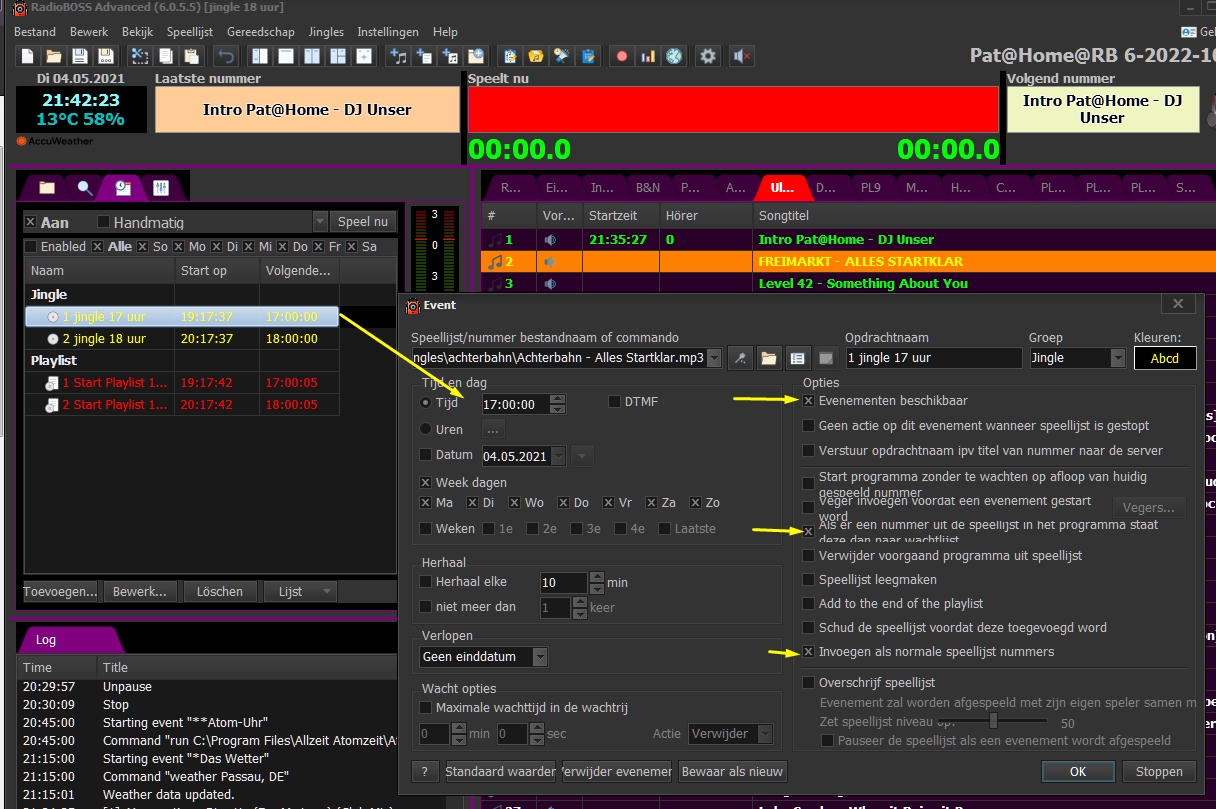

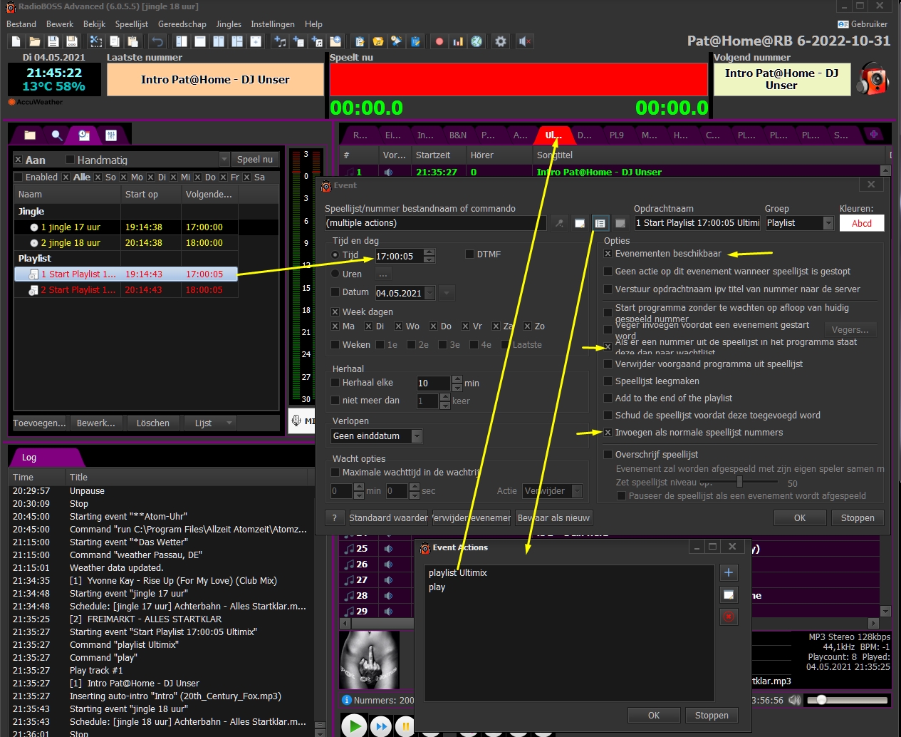

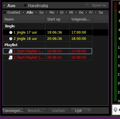

Zie de Beelden, bij:
Jingle 1 wordt om 17 uur een jingle gespeelt
Playlist1 wordt om 17 uur en 5 sekonden de playlist Ultimix gestart
Jingle 2 is een copy van jingle 1 waar enkel de tijd veranderd is
Playlist 2 is een copy van playlist 1 waar je enkel de naam van de playlist moet veranderen in de multiple actions
See the Pictures, at:
Jingle 1 is a jingle played at 5 pm
Playlist1 starts the playlist Ultimix at 5 p.m. and 5 seconds
Jingle 2 is a copy of jingle 1 where only the time has changed
Playlist 2 is a copy of playlist 1 where you only have to change the name of the playlist in the multiple actions

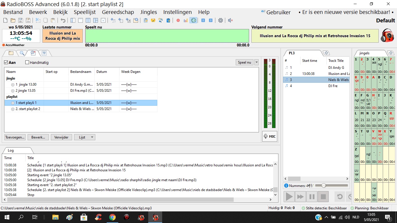

Best
view photo I have set it up as you have mentioned above
he starts the jingle 1 and playlist 1
the music in playlist takes longer than jingle 2 starts ...
it starts the jingle 2 and playlist 2 but it doesn't overwrite the music from playlist 1 so you won't hear anything from event 2 at all.
