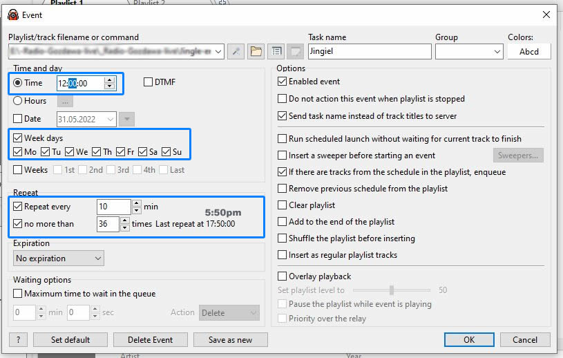

Good day. I have music blocks, I would like to describe them in jingles. Each block starts at the specified time. e.g. from 12:00 to 18:00. How to set the calendar so that the selected jingle turns on at 12:00 and is activated every 10 minutes. I have the jingle off setting.

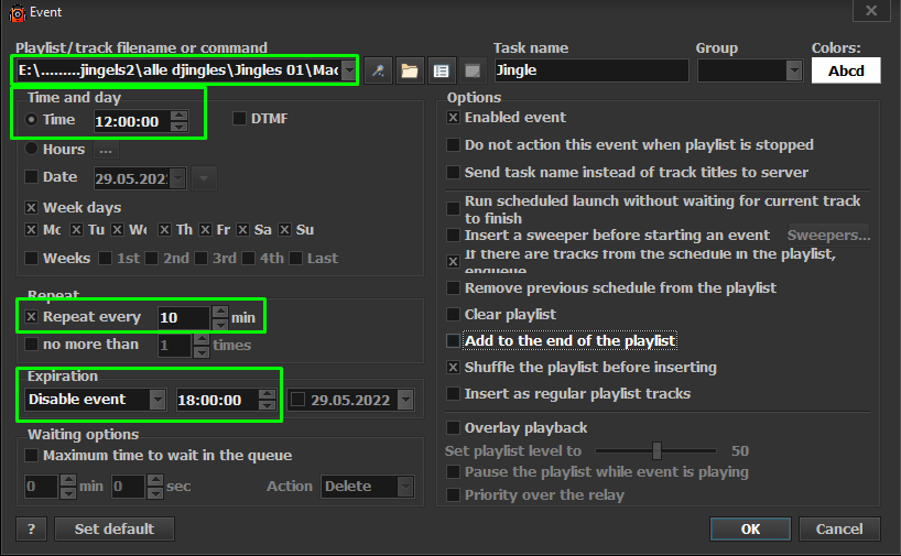

I thought so too. I checked, it doesn't work. If he is programming the setting at 9:00 am, and you want the jingle to start at 12:00 every 10 minutes and end at 6:00 pm, it starts right after saving at 9:10.

You can limit the number of repetitions so different events do not overlap. RadioBOSS will calculate you when the last repeat will be so it's pretty easy to configure.

I have entered the settings you proposed. On the next day, the jingles didn't start. The days of the week were set. The end was set to a specific time. The system is active only when you set the end date in the calendar for a few weeks. It is strange that selecting the days of the week did not affect the continuation of the setting without setting a date limit.
I solved the problem. I do not need to mark the end of the jingle emission. I did not understand the full description in the help on the program page.
