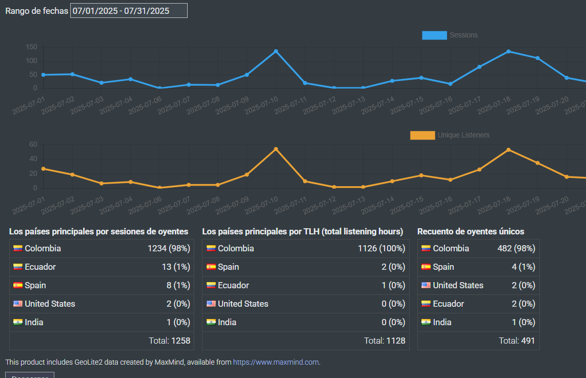

Hello, I appreciate your help in advance. I've been analyzing the reports that Radio Boss Cloud offers but can you please explain what the information under “Listeners” means, because I see that the information on the platform online and the reports that I download as PDF does not match.
I understand that "Unique listeners" refers to the number of distinct individuals who have listened to a track during a specific time frame, counting each listener only once. I guess that the item named “Sessions” refers to the number of interactions, for example only one unique listener had two interactions.

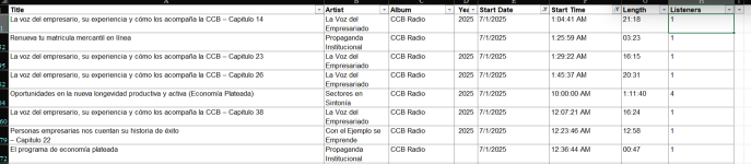

I’m confused because for example, if I want to see how many “Unique listeners” I had from July 1st until the 31st on the platform it says that I had 491 but if I download the report, I see 6971 “Listeners”.
Yes, this is correct. Basically, both those metrics calculate the number of connections made to the server during the specified time period.
"Listeners" metric in the downloadable reports shows how many listeners were connected to the server when a music track was started.
