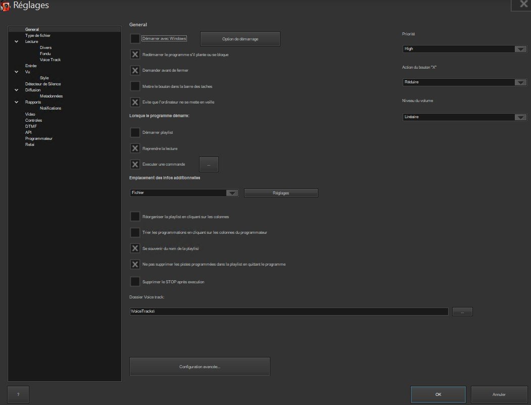

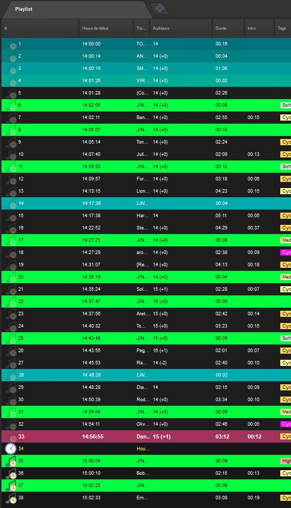

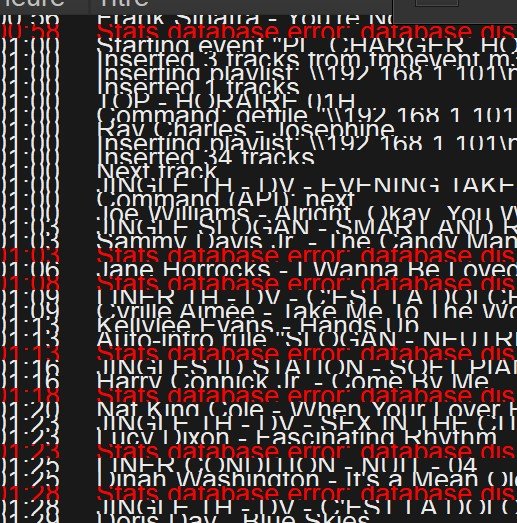

The screenshots attached to this message are real. You need a magnifying glass to read them in the software.
The problem is either very small or very big.

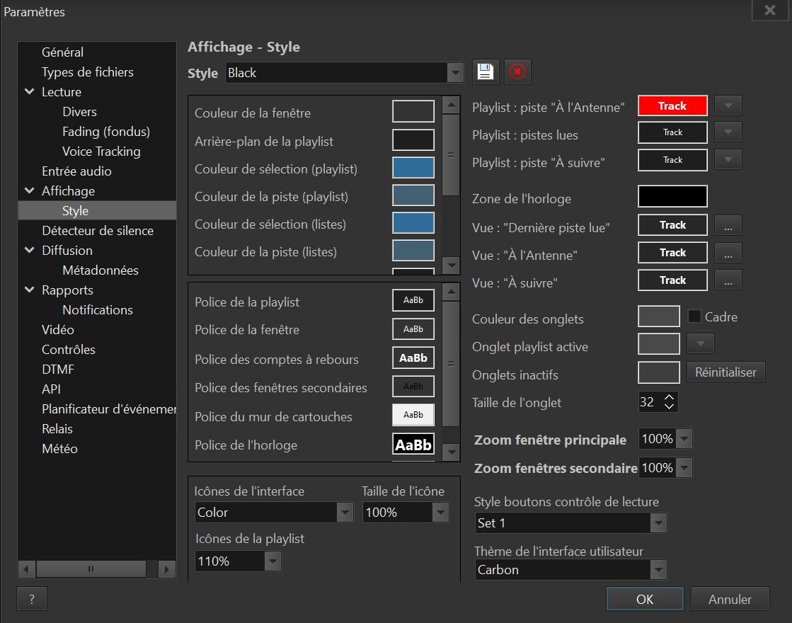

I think you should be able to fix this by adjusting the font sizes/UI scale in Settings > View > Style.
Unfortunately, that doesn't solve the problem at all. I tried basic fonts and basic styles, but it doesn't change anything.
For secondary windows, try playing with font sizes and zoom setting. For the main window, font sizes. The issue should be addressed in RadioBOSS 7.2.

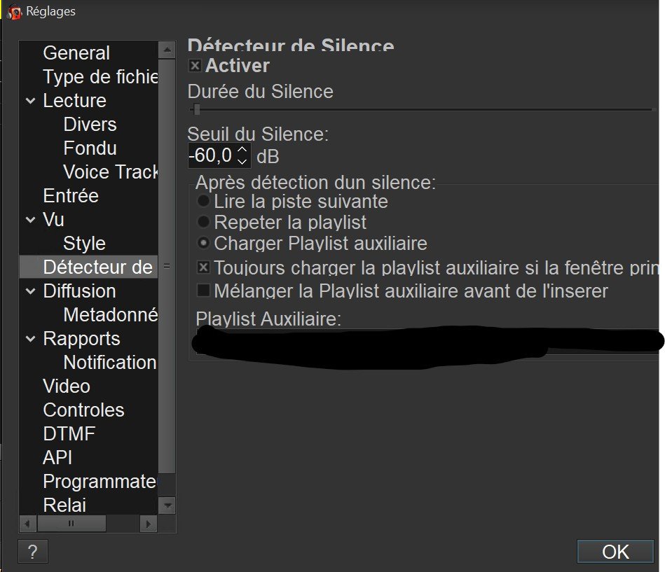

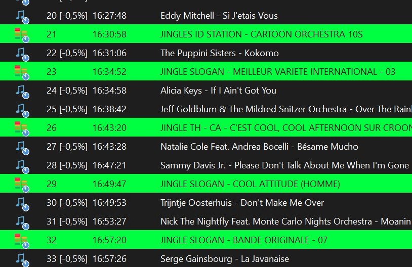

Just to provide an update 7.2.1.8 : unfortunately, the latest version has not fixed the GUI scaling issue. The display problem still persists when using a 4K monitor inside a Windows Server 2022 Hyper-V virtual machine.
You can clearly see the issue in Screenshot 1. I should also point out that sometimes the visual glitches and distortions are much worse than what is pictured here.

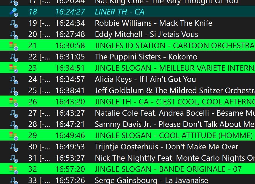

Interestingly, I found a temporary workaround: if I go into the Theme settings and simply click "OK" (Screenshot 2), the interface scales correctly again, as shown in Screenshot 3.
For your information, this bug happens with all the default themes (I am using the "Dark" theme in these screenshots).
I hope these details help you reproduce and fix the issue. Are there any plans for a patch?

This is a known problem, but we don't have a solution for it at this moment, unfortunately. It does work fine on a native 4K monitor, but why it has problems with Hyper-V, is unknown.
