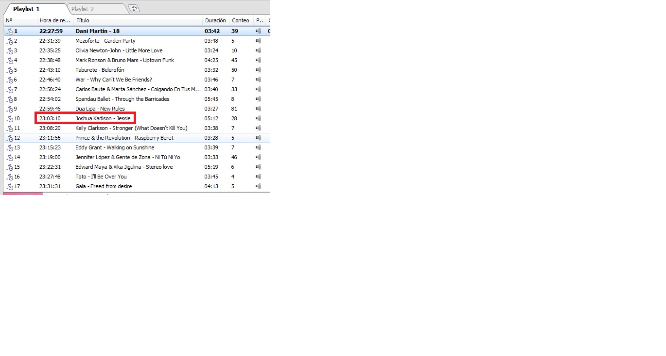

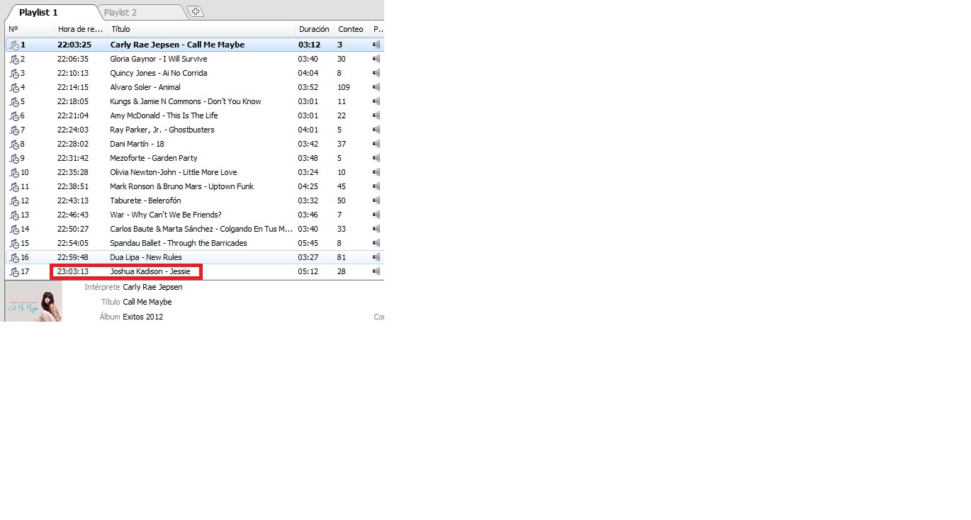

It is 22:03 and a playlist is reproduced. The song "Joshua Cadison-Jessie" is foreseen that comienze at 23:03:13.
20 minutes later it indicates that it is going to be issued at 23:03:10.

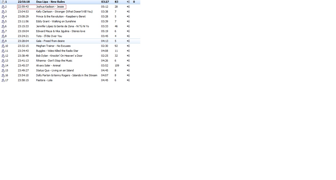

And other 15 minutes later it indicates that it is going to be issued at 22:59:43.
In approximately 55 minutes the difference that it accumulates is almost 3 minutes...
This way it is impossible to fit the times in the playlist. Thank You

By default it calculated approximate start time - for performance reasons. You can make it calculate the exact start time, please see this guide: https://www.djsoft.net/smf/index.php/topic,4598.0.html
