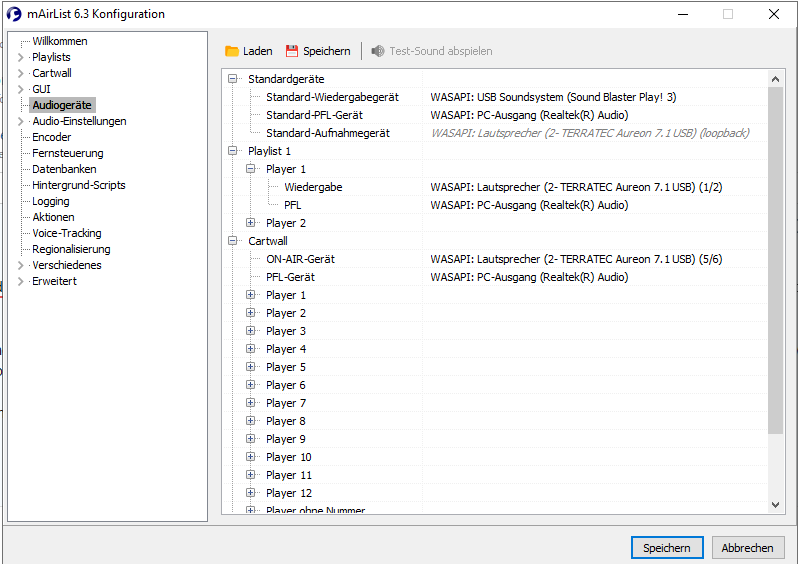

Also, I am currently running mAirlist with the Behringer DX2000USB and would like to use the playlist on one channel and the cartwall on a second channel.
Attached, I have posted a screenshot of mAirlist as I would like it to be.

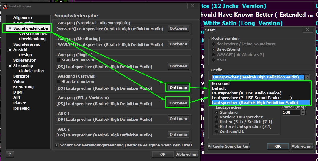

In den Sound einstellungen kannst du für alles separate ausgänge wählen die du dann auf dein Mischpult leiten könntest
Beachte aber das ohne Mischpult die Cartwall auf den standartausgang liegen muss da sonst keine ausgabe zum stream
In the sound settings you can choose for all separate outputs that you could then route to your mixer
Note that without mixing console the Cartwall must be on the standard exit since nothing else does not have any issue to stream

Problem dürfte sein das RadioBOSS nur das Mischpult als Ganzes und nicht die einzelnen Kanäle erkennt (siehe sein Bild von der Konfiguration in mAirList). Im Player hat er 1/2 und in der Cartwall 5/6 eingestellt.
Problem might be that RadioBOSS only recognizes the mixer as a whole and not the individual channels (see his picture of the configuration in mAirList). In the player he has set 1/2 and in the cartwall 5/6.

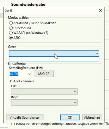

When ASIO is selected, unfortunately no selection appears (see screenshot).
For some inexplicable reason, the DX2000USB can only be inserted as a whole via WASAPI, but not individual channels.
It seems there's no ASIO driver available for this device. Do you have any other software that supports ASIO, does it see this device?
