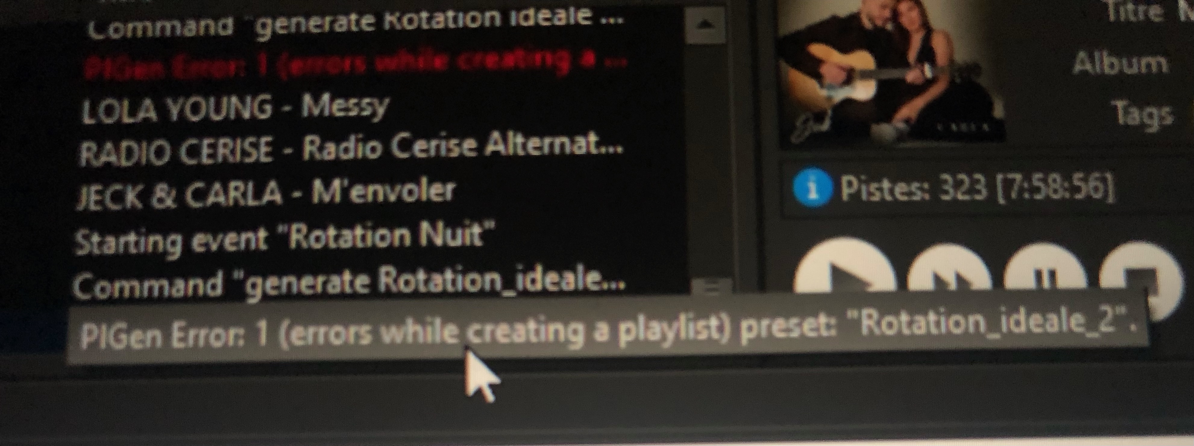

I expressed myself. I have the same problem as you!
