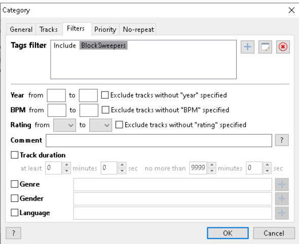

This is the main filter we use, is this slowing things down at all?
(We definitely have SQLITE enabled for additional information.)
I don't think it will introduce a huge speed decrease. Playlist creation time also depends on the CPU speed, and if the music files were modified outside of RadioBOSS or any of its tools (in this case it will read the tag again to update the cache).
