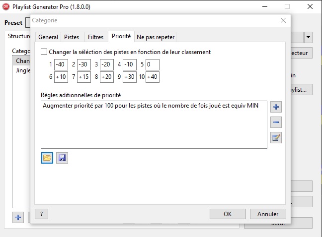

Can you please provide more details on what you want to do?
Good evening
I'm looking to play the least broadcast titles see not at all. I tried some things (screenshot) tell me if it's like that
How does the ranking of titles work?
You can have a rule like "Increase priority by 100 for tracks where playcount less than AVG" - this will increase probability for tracks that play less than others.
