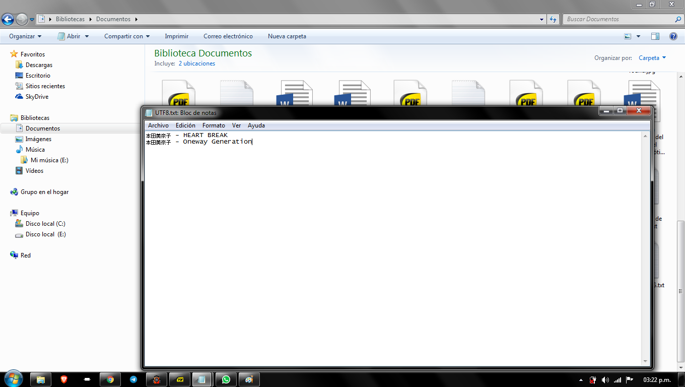

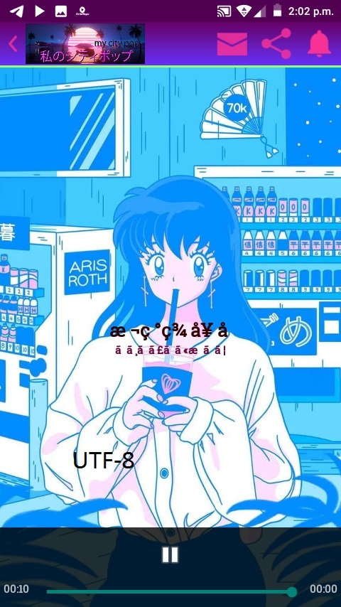

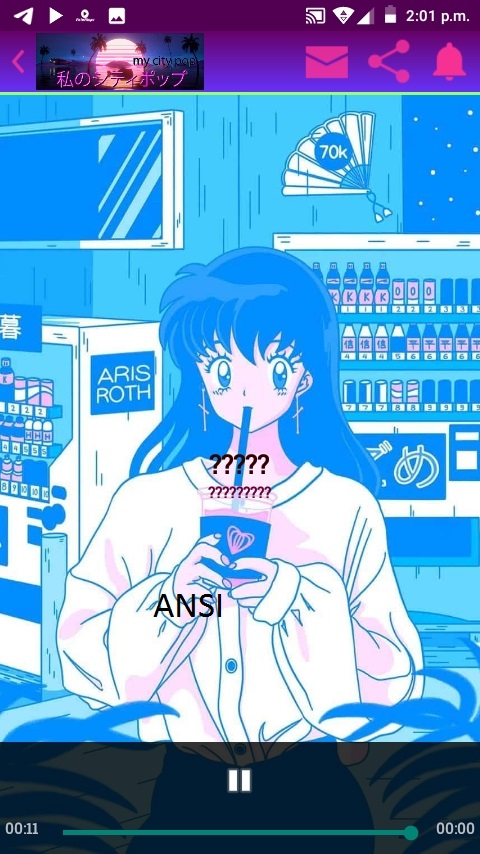

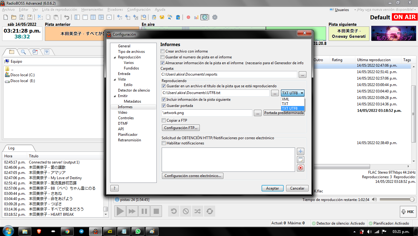

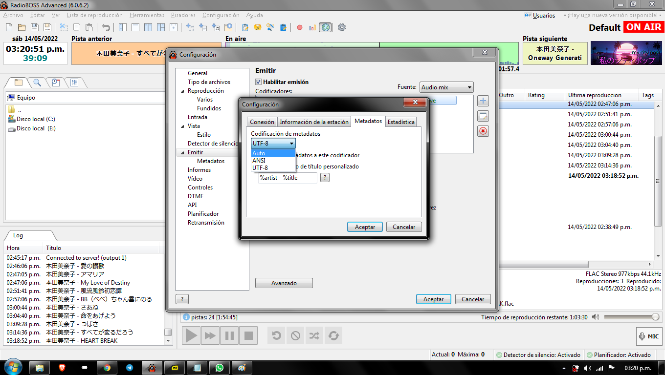

good afternoon or evening, I'm starting to broadcast, but I don't know if it's a particular configuration, the program or it has to do with my server, since when I play the metadata of songs in Japanese or Chinese format it is displayed with ?? ?? or if not with somewhat strange letters
so I would not appreciate it if you could guide me on whether I need any other program so that the Asian characters can be displayed

It also depends on the server you use, if it's Icecast it needs to be configured to also use UTF8 encoding for mount point metadata.
