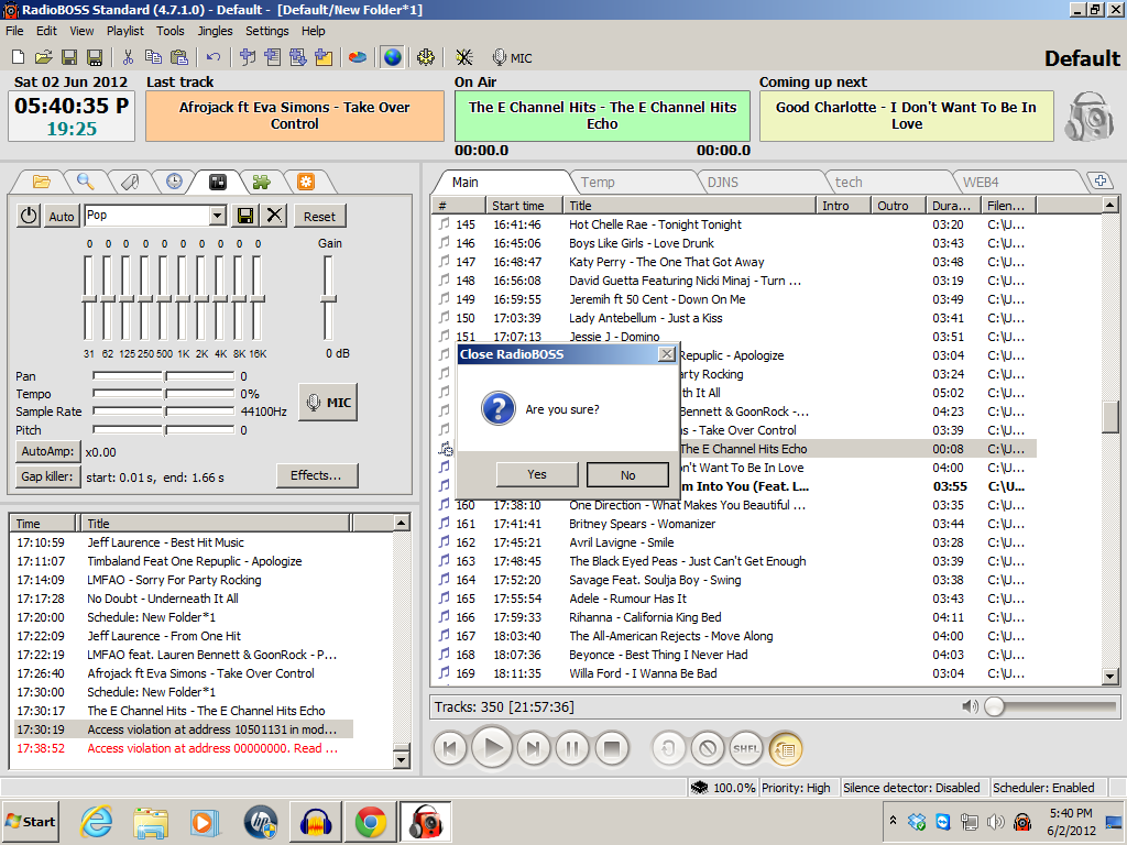

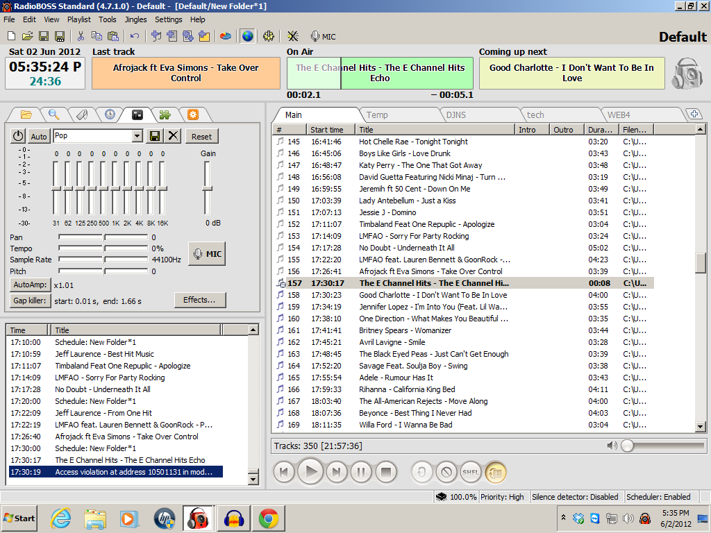

This is getting ridiculous. I installed the 4.7.1 update and then 8 hours later RadioBoss crashed. Then I restarted it and then 13 hours later it crashed very bad. I thought 4.7.1 was supposed fix all these problems not create new ones.

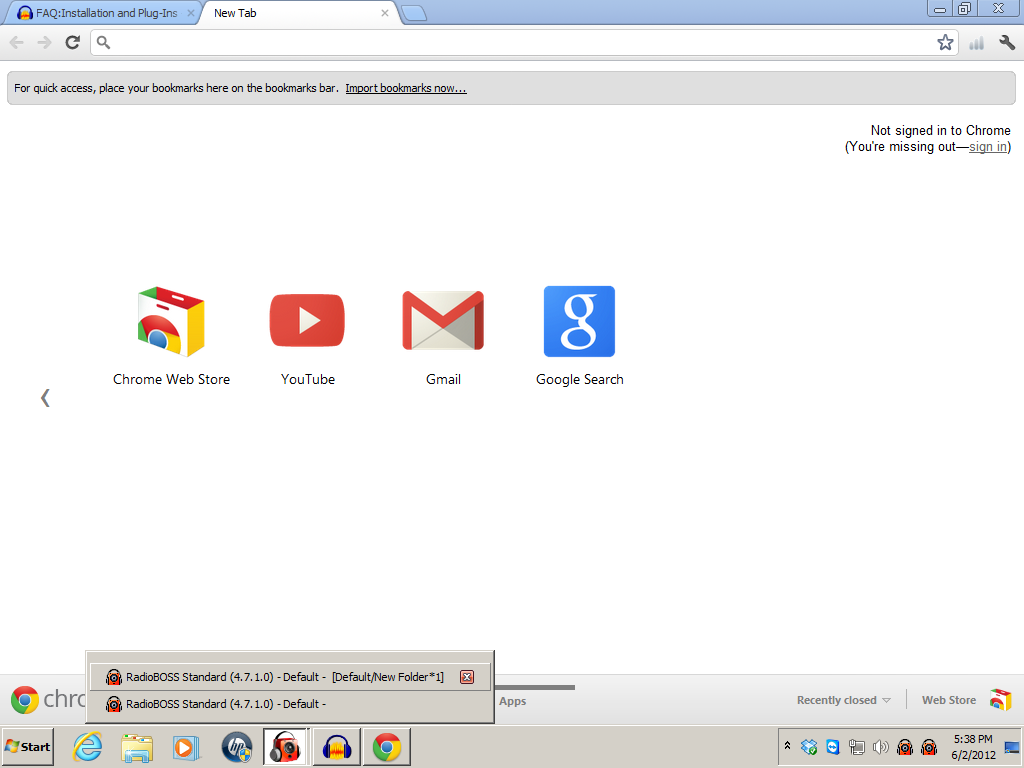

RadioBoss was working fine then an error code popped up and it stopped working. I couldn't play anything from the playlist. It wouldn't start. So I exited the program and reopened it. However though 2 RadioBosses opened. The one I just closed and a new one. I have prevent multiply ones check off in  the settings checked off. When I tried closing the new one it closed fine. Then when I tried closing the other one a anther error code popped up and it completely froze. I had to force close it from task manager. Please fix these problems or I will be forced to move to a new automation software!

The RB 4.7.1 release solved problems for other users... And testing here shows that it is absolutely stable.
What is the PC configuration where you are running RadioBOSS and what is Windows version? Check that there are no other programs (or viruses) eating all memory or CPU resources, because "access violation at 00000000" usually means that there's not enough memory for operation.
I think you should do a fresh install, bring only scheduler events from the old installation (on the scheduler tab, click List->Save to save events to the file, and on a new installation click List->Load to load events).

The new RadioBOSS 4.7.2 will be released today, you should try it. Regarding the crashes you've reported... it's difficult. Very few users still experience crashes, about 1 crash in 2-3 days.
As you're using Windows 7, it means that program uses WASAPI output by default. You can try switching to DirectSound (Settings->Playback->Main soundcard), probably this will help.
