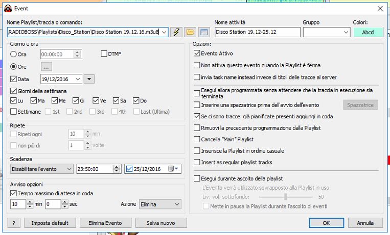

Hello, When imposed "maximum time to wait in the queue" in the scheduler events, this rule are not respected.
How to fix this problem?  ???

There are setting errors that can be noticed in the figure?

I see that the event starts the playlist. If that playlist started playing before timeout, then it will not be deleted - all tracks from the playlist will play (and timeout will be ignored).
This I know it! I removed and put back all the flags, but I see that still does not work. This event in the picture for example was to expire at 10:29, but was aired at 10.35  ::)

I think I understand the problem. Probably the playlist was too long (he had thousands of songs broadcast that were added on days). Removing it and creating another, now it seems to work.  :)
