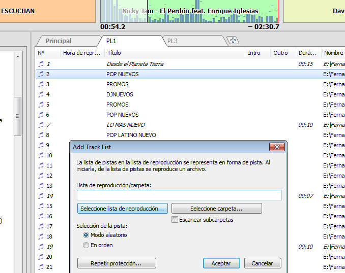

I do not make playlists with the "Playlist Generator Pro", created a playlist in M3U and then I think the list of different musical genres and new and old, etc. As in the picture, they forgive me because it is in Spanish.
There you can see I do not use the "Playlist Generator Pro" because it does not mix the end with one track to the beginning of the next, from the way I have my station if the mixture because the songs are chosen from a M3U lita. I asked them to you that which would cause and you told me you did not know, yet they released a newer version of the program but does not mention anything about this problem that the songs are not mixed.
This is not correct. Playlist Generator Pro only creates playlists, it does not perform any actual playback or mixing. This is handled by RadioBOSS. No matter how your playlist is composed (manually added tracks, generated playlist, scheduler), it is processed the same, according to your crossfade settings.
The crossfade settings that are used when playing tracks (in priority order):
- Segue Editor crossfades: http://manual.djsoft.net/radioboss/en/segue_editor.htm
- Individual track crossfades that you set in Track Tool: http://manual.djsoft.net/radioboss/en/track_tool.htm
- File type crossfades: http://manual.djsoft.net/radioboss/en/using_different_types_of_files.htm
- Global crossfade settings: menu Settings->Crossfades. Here you can specify crossfades for music tracks and file types.
Make sure your crossfade settings are not set to zeros, and that file types are set up correctly, and that you didn't set zero mixing points in Track Tool.
