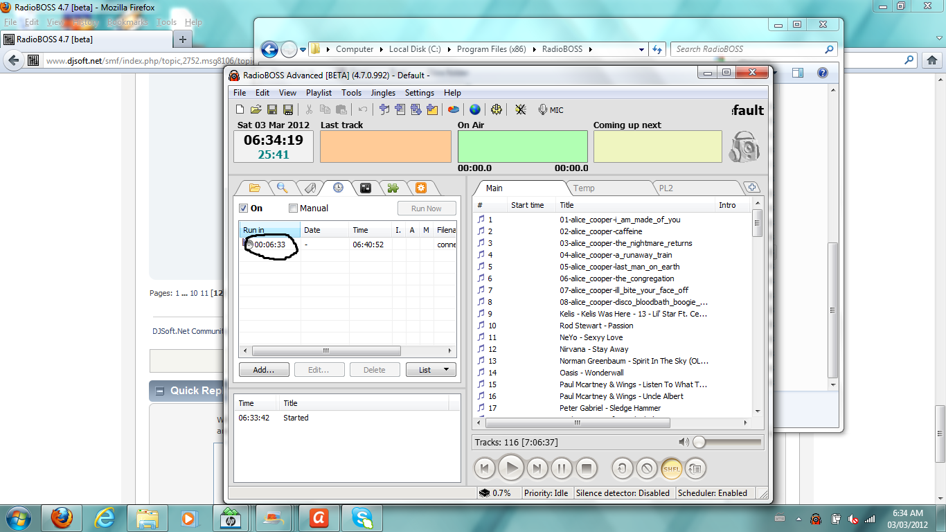

Hey djsoft
take a look at this screenshot please
this is what i ment by asking you to remove the schedule timer
thanks

There should be a option were we can chose what tabs we want in the scheduler. If you don't want the "Run In" tab than you can get ride of it. Then in the future if you want it again, you can click add tab and put it back.
You can resize this column to have zero width, this will make it not visible.
