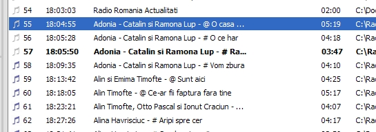

Current Track not Highlighted
It's OK on the screenshot (the current track is bold). Or did you mean highlight the track under mouse cursor? If so, check in the setting what color is set for highlight.

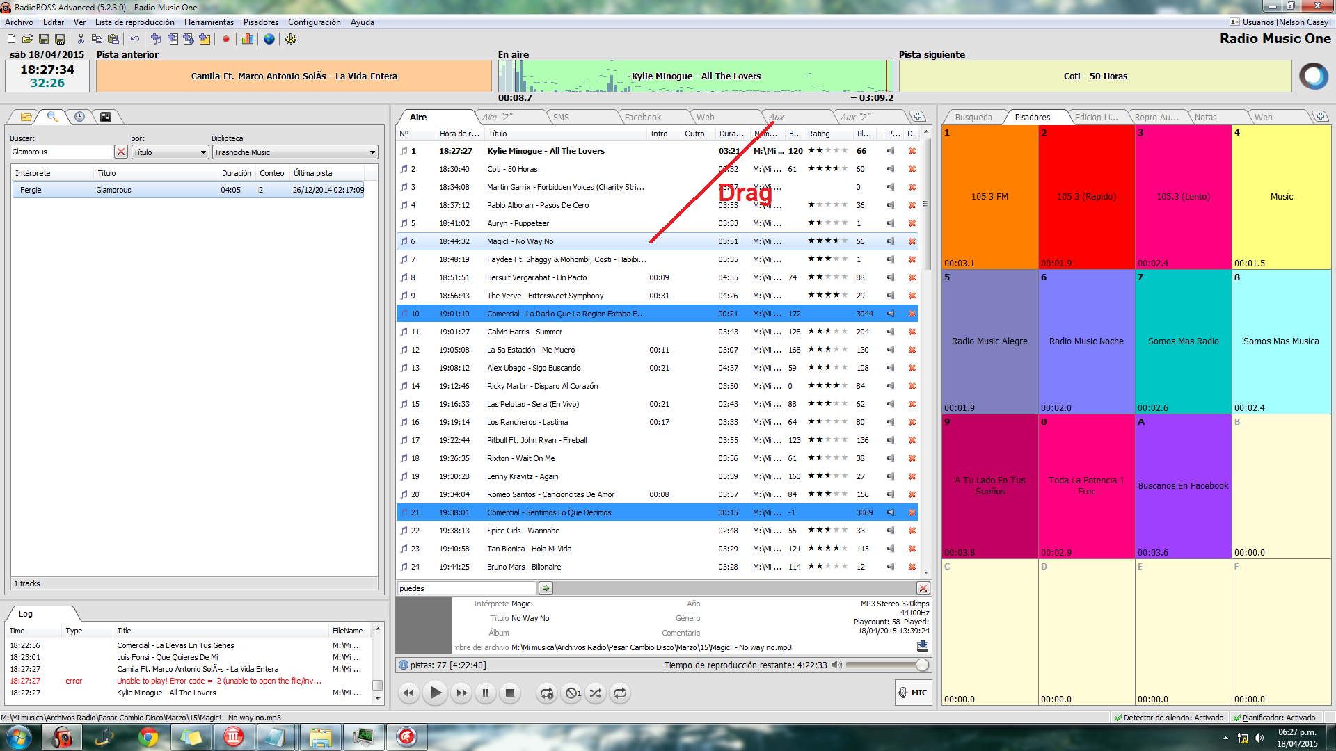

I have the following idea that can be very practical.
To move songs from one list to another instead of adding this option the PopUp menu is could drag flap tracks to the playlist (see image)
It's possible already: drag a track by its icon on another playlist tab.
I did not know that this was implemented :), great!
(It was tested on 5.2)
