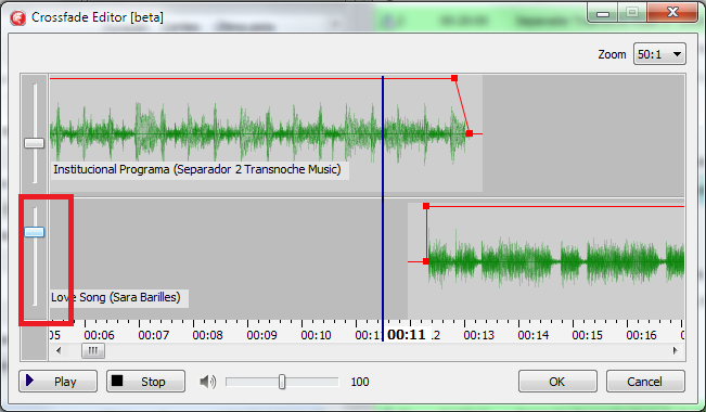

About Sigue Editor:
The last beta, remains a problem with set the volume in the pre-listening.
Track number "1" works to level set perfectly.
Instead two track is not affected by the volume in the pre-listening, unless you change the volume level while already started ringing that track in the pre-listening.

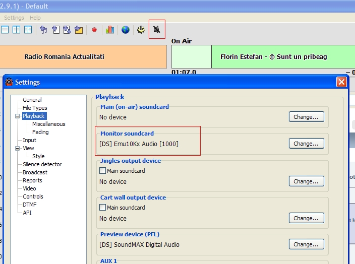

RadioBOSS settings:
- Playback - Monitor soundcard (ONLY)
- Input 1
- MIC
When MIC is ON Monitor doesn't stop.
Monitor must stop when MIC is ON.
Try changing to use the Main sound card instead of Monitor, it should fix the problem. The monitor card is processed slightly different compared to "Main".
Monitor works in operator room. When MIC is ON Monitor must be stoped.
Exactly the same principle is respected in the other versions and works very very nice.
So right now beta version doesn't function right. Monitor must stop when MIC is ON. Otherwise MIC will get the sound from two sources (Operator voice and Monitor Speakers) and the result is an annoying feedback. There is a principle here wich must be respected in a radio station.

I think pety`s problem must have "checkbox" for what he wants - "disable MIC through Monitor when MiC is on".
If user wants NOT to hear the MIC on the monitor , then check the box and everything is OK. If he wants to hear what he speaks "quitely on the speakers" , then NOT check it.
As i realize right , Pety wants NOT to hear only the Microphone in the Monitor output? but the Music to go on , right ?
Thanks for reporting, will be fixed in the next update.
If I'm not mistaken, monitor wasn't changed in this version. I'll add it to the list of bugs for now.

This is the situation:
- In Live room there is Moderator (wich operates RadioBOSS, Mixer etc., etc.);
- In the same room there are co-hosts;
- There are Monitor Speakers in the room;
- When Host and co-Hosts go in Live, then Monitors should be cuted when MIC is on. Becouse Microfons will capture the voices and Monitors too. That means an annoying echo (feedback).
I am talking about Monitor, not Main (on-air) soundcard
