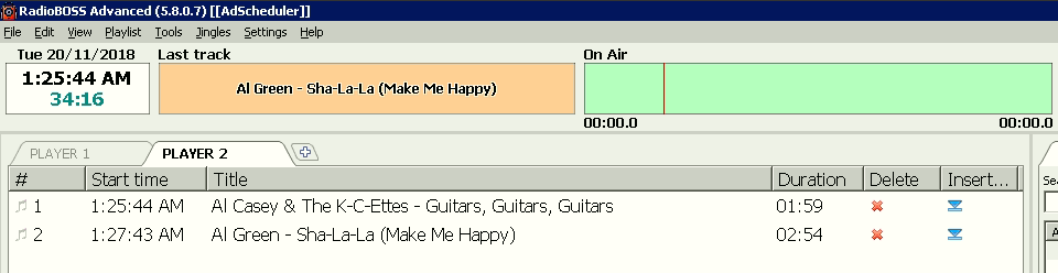

Minor bug:
'On Air' section has a red line that goes across to show the currently playing part of the track. If 'Stop' is pressed, the bars disappear from the 'On Air' section, and the red line holds in place. If 'Stop' is pressed again, then the line disappears.

Minor bug:
It appears to be a bug, will be fixed in one of the next update.

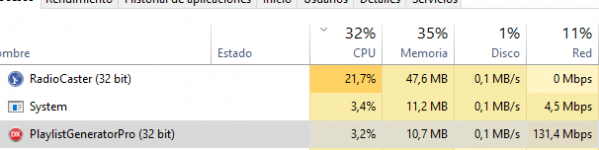

Hello Dmitry,
I am using PlayList Generator Pro in network, with MySQL (With tag cache).
However, I am looking at a very large transfer. (It seems to be analyzing the files).
There may be a problem?
I'm not sure, it could be database requests, as it will make a request for every file. It should not read the files as all the information it needs is in the database, but we'll check if there's a bug and it still reads the files for some reason.
