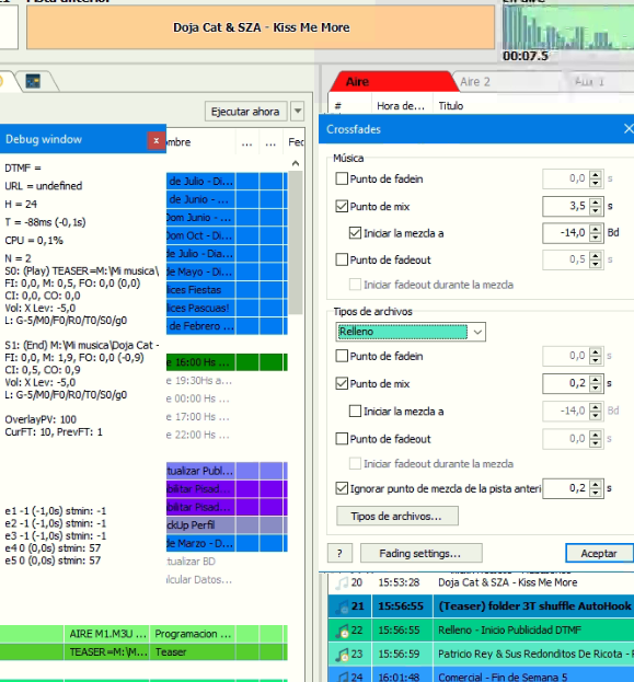

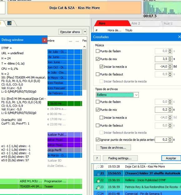

Please click Ctrl+F4 when you have the Teaser playing and make a screenshot of the window, it will show the actual crossfade parameters it uses.
Here I attach a screenshot

Of all these values, what is the mixing point? Is there a bug there?
It's the M: value - on your screenshot looks correct. Further testing is needed about this, maybe it's not processed correctly because the Teaser is created dynamically and doesn't have defined length.
