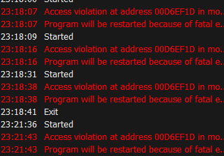

I have a Problem after installing Radioboss 7.0.0.6 32 Bit
Same problem after a clean install Radioboss 7.0.0.6 32 Bit
Report:
23:08:59;system;Started;
23:09:06;error;"Access violation at address 00D6EF1D in module 'radioboss.exe'. Read of address 000000FC.";
23:09:06;error;"Program will be restarted because of fatal error.";
23:09:21;system;Started;
23:09:29;error;"Access violation at address 00D6EF1D in module 'radioboss.exe'. Read of address 000000FC.";
23:09:29;error;"Program will be restarted because of fatal error.";
23:09:42;system;Started;
23:09:50;error;"Access violation at address 00D6EF1D in module 'radioboss.exe'. Read of address 000000FC.";
23:09:50;error;"Program will be restarted because of fatal error.";
23:10:04;system;Started;
23:10:12;error;"Access violation at address 00D6EF1D in module 'radioboss.exe'. Read of address 000000FC.";
23:10:12;error;"Program will be restarted because of fatal error.";
23:10:26;system;Started;
23:10:34;error;"Access violation at address 00D6EF1D in module 'radioboss.exe'. Read of address 000000FC.";
23:10:34;error;"Program will be restarted because of fatal error.";
23:10:35;system;Exit;

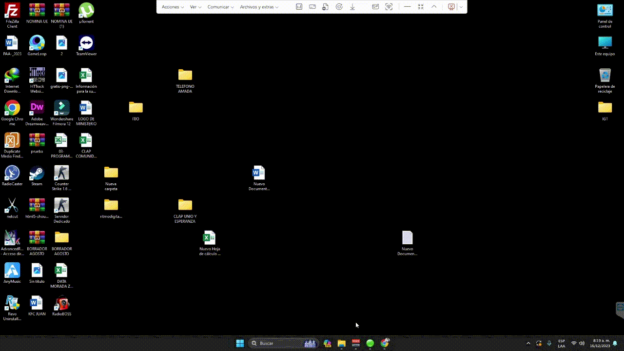

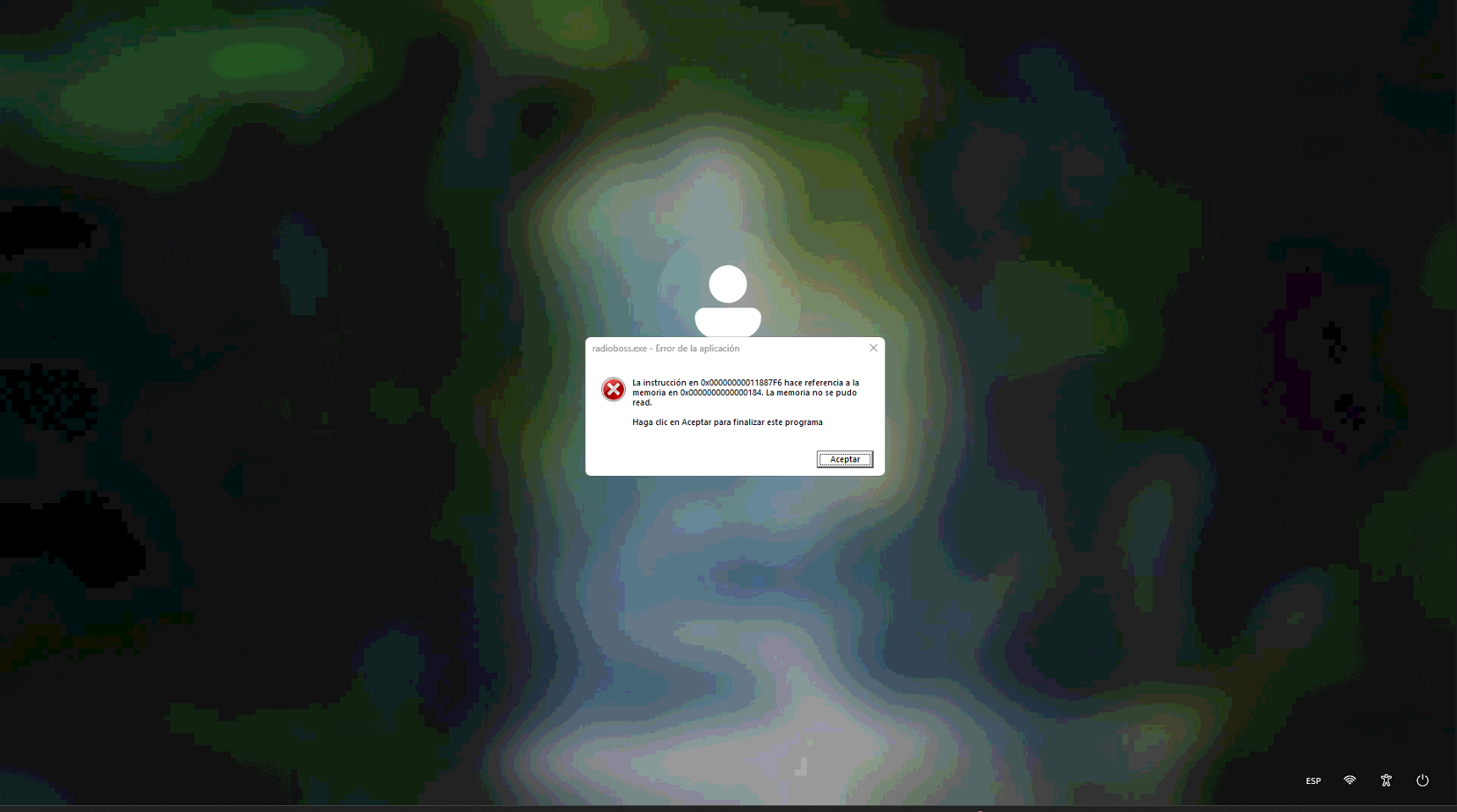

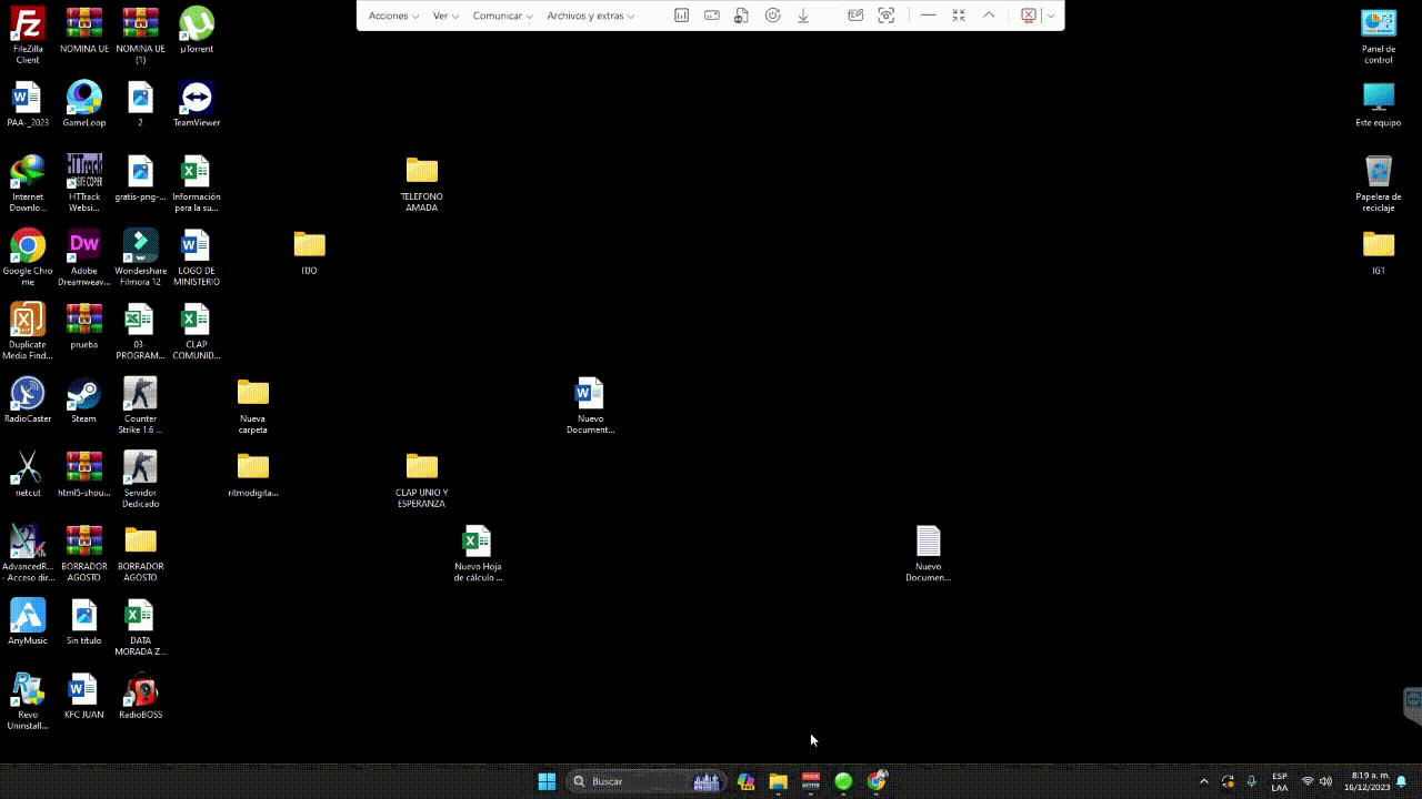

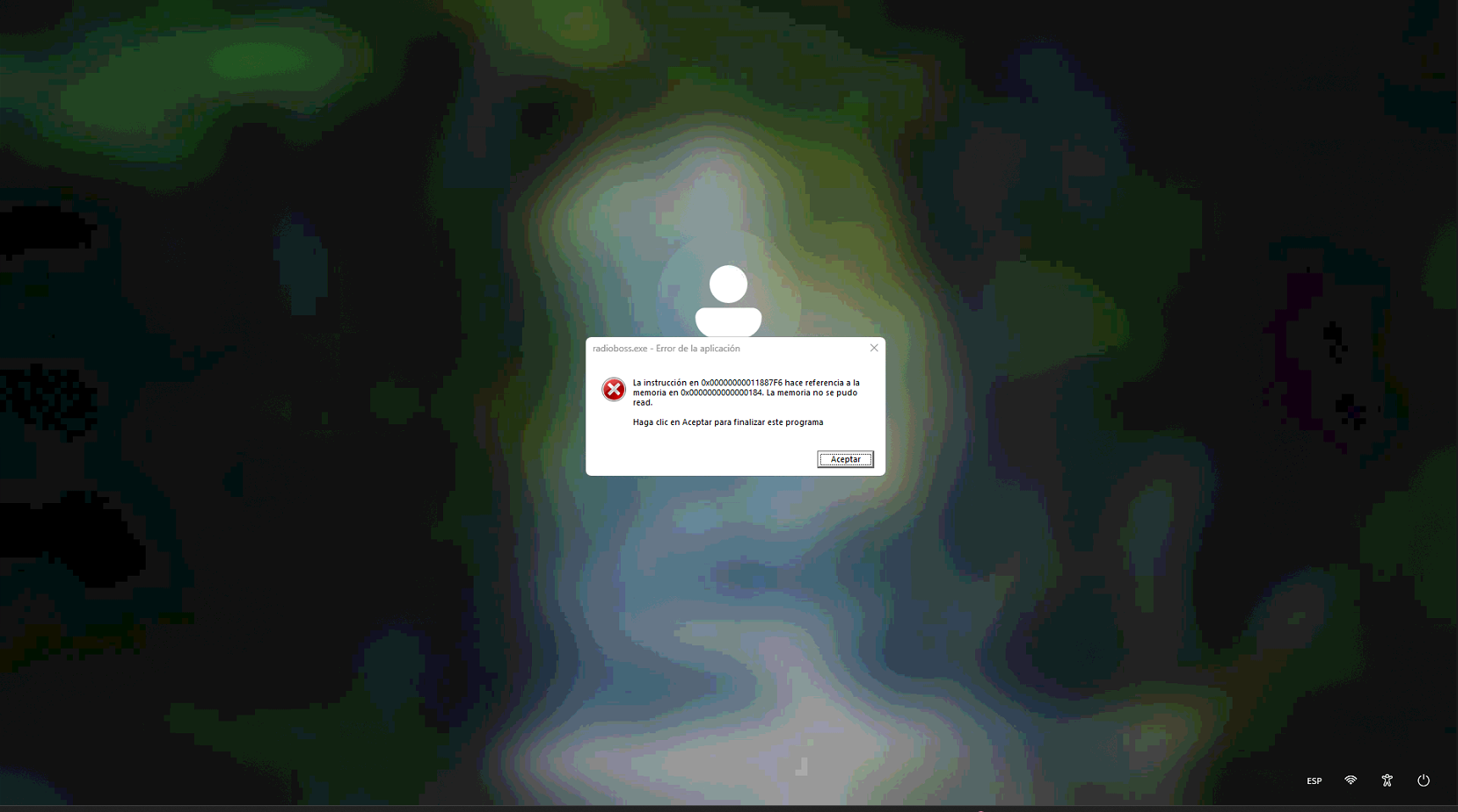

I have a problem as seen in the log. But when sending an error report it says what is in the image.
The program closes and opens automatically
