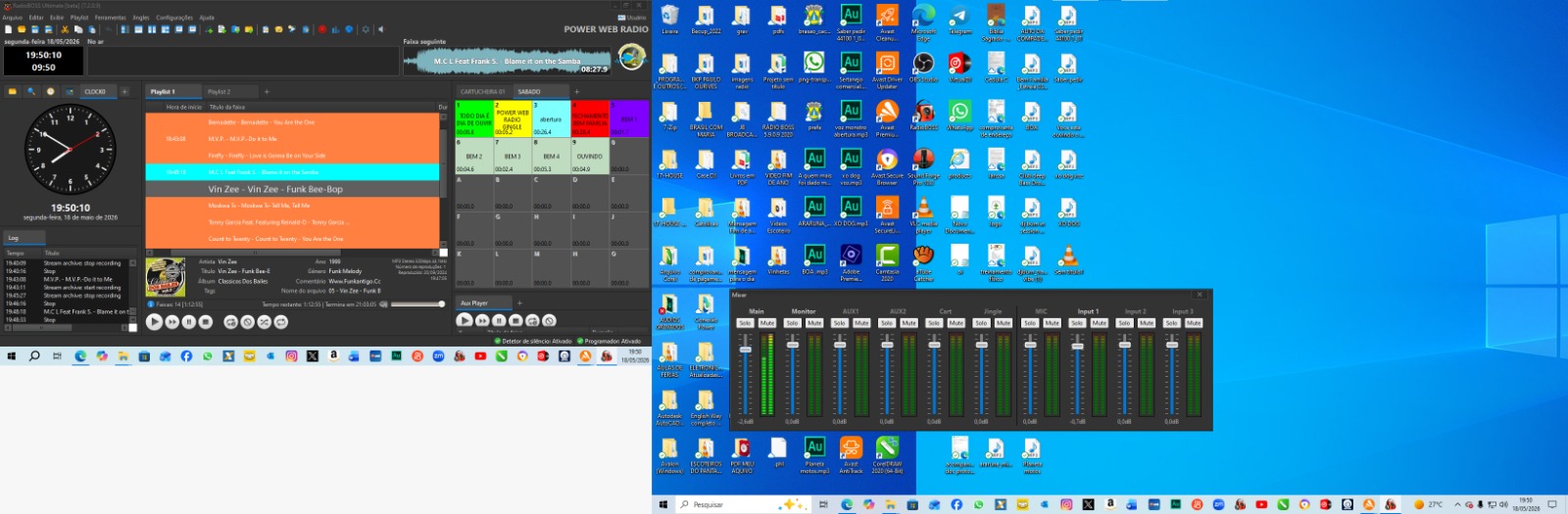

In the new version of Radio Boss, regarding the virtual mixer, I noticed something related to two points: the microphone channel and the master channel. I observed that when configuring the microphone, I have to leave the channel open to speak, lowering the master volume and raising and lowering it as I speak. I thought the mic would turn off and on, because when I turn off the mic, the master volume is cut off, but I'm operating it by lowering the master volume and speaking normally, and it sounds just as good as on a mixing console. Another thing I think is that there should be the possibility to increase the pixel size when using it on a screen, as in my case. Please look into this. But in the end, everything is becoming good and beautiful, modern, which is what I want for Radio Boss: something better and more futuristic every day. This program is what best satisfies internet radio users. For me, I am a happy user, very happy!!!
The mixer doesn't control volumes automatically, it's designed so you manually adjust what's needed. For the microphone, there's another feature in Settings > Inputs to automatically lower the music level when the mic is on. But it's not done via a mixer, it's internal gain adjust.
It should take into account the "Secondary window zoom" option as set in Settings > View > Style.

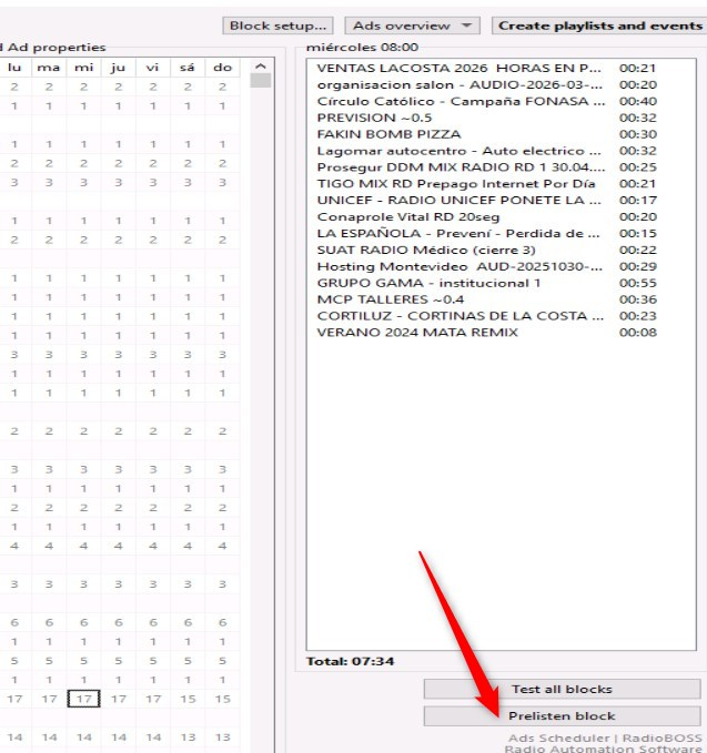

In Ads Scheduler, when you click the 'Prelisten block' button, you can hear all the ads in the block, but with a mix (mix point, fade-in, and fade-out) that doesn't match what is configured in RadioBoss. Therefore, what I’m hearing isn't actually what will go on the air.
Is it possible to use the settings specified in RadioBoss?
Mix point can't be used there as it's only one track is playing and it's not mixed with anything. Prelisten there is designed to check what the music file is, it's not supposed to take into account track configuration; prelisten in Music Library and RadioBOSS itself (in playlist and search) works the same.
Maybe I didn’t explain myself correctly, but I’m talking about that button, the one marked with the arrow.
There, several commercials can be heard, in this example, there are 17.
If it mixes them with at least 2 or 3 seconds of overlap, could it at least avoid mixing them at all, so they play one after another without any mixing?

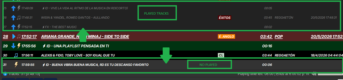

In the playlist, when the window isn't selected, the selected track appears in gray. This color is very similar to the one I already use for played tracks, which is confusing because I believe the "selected" track (screenshot) has already played. Is there a way for the user to configure the color of that selection so they don't have to assign a different color to played tracks?
Currently it plays in about the same way as if it's played in the playlist, but it loads the default file types/crossfade settings. In the next update it will set all mixing/fading to zero.
On your screenshot, the tracks look very different, the unplayed track has white font while the played tracks have grey font.
