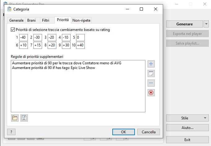

From the Playlist Generator, I tried first, with the Playlists, applying the necessary parameters and rules to them and nothing happened. Then I generated the playlists automatically without success. If you want, I'll attach some screenshots to check where I'm wrong.
Playlist (the one you create in RadioBOSS window) is merely a playlist window where you can add tracks and they will play, from top to the bottom, in random order, repeating - depending on what playback options you enable. The playlist window itself doesn't have any repeat protection rules.
What "without success" means? Do you see error messages, or playlists are not what you want them to be? In case of latter, I think you should check your rotation if it's configured properly.

1. All the playlists I created that appear in the RB window (after I realized that even applying repeat protection from the RB "Playlists" screen "Don't Repeat Tracks" didn't work. ..and I don't understand why this function was inserted..!) I loaded them from "Playlist Generator" paying attention to all the rules..so that the tracks are not repeated, I activated them in the RB window and nothing changed ...The tracks are always the same and continue to repeat themselves.
2. Then, I saved the same playlists in a new folder, I created the categories, for each Playlist I created the Tgas (naming them like the title of the Playlist or Rotation), I applied all the necessary rules, paying close attention and following the various advice on the forum, I saved the presets and started RB. Nothing has changed.
I'm probably wrong about the repetition rules.
I would like my playlists to change "every day", not repeat the artists and songs.
How you do it? If you want I will also add screenshots of the various steps.
This is exactly what I want to understand how to do it...?
Is there a tutorial, an explanatory link?
Thank you so much!

I've been trying to figure out how to "not repeat artists in my playlists" for weeks, but to no avail. I asked for a link and I was given the guide (which I now know by heart like a poem..!). It didn't solve anything.
I have a series of playlists that I need to activate but I always see repeated artists...!
What's the point of not repeating tracks in the RB window if it doesn't work...?
I'm working through the playlist generator...but nothing at all!!!
I applied all the instructions as per the guide, but nothing...
Is there any good person who could help me? I can attach screenshots. Maximum availability. Thank you in advance.
